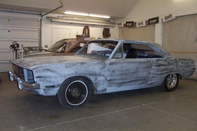

This. I know, I know, its an A-body but after 35 years of Bs, Es and trucks this is the first A that I'm building.
Mini tubbed and inboard springs.
440 727 8.75 for now. Hope to build a 512 later.
Trying to get things finished up before paint. Still need to install the frame connecters and need to decide my traction path.
Will see both street and track action.

Are you planning on getting rid of the leaf springs? Ladder bars and leaf springs are really doubling up on suspension......I really don't think they will work good together. I've seen it done, but IMO you'll be better off with either one or the other, not both. Ladder bars are made to work in conjunction with coil over shocks. The coil overs take the place of the leaf springs.
Rusty, They also work when using the full floater rear axle setup with leaf springs.... Agreed,,, coil overs would be better though.
Ya was planning on using leafs. They have already been move inboard. Don't have the money for coil overs. I've installed lots of coil overs and air bags, just not on my cars. I've seen alot of people running ladders with leafs. Didn't know there could be a problem.
I believe the floater kits are pretty cheap...... it allows the axle angle to be adjusted and tuning of the 4 link system.
Well, what happens is, the ladder bars change the arc at which the rear axle travels. So the ladder bars and leaf springs will bind without either eliminating the leaf springs and going to coil overs or adding the leaf spring floaters as 67 B-Body mentioned. At least that's my understanding. I've never had a reason to run ladder bars. I know they work, but when there are cars running in the 8s at over 160 MPH with leaf springs, I just never saw a point. Again, not that they won't work properly set up......I'm just not sure you can just bolt them on with leaf springs and go. I could be wrong.
Another thing to consider is you will lose some of the independence that the leaf springs offer. In other words, with ladder bars, when one side squats or rises, it will take the other side with it, where as with leaf springs, there is some independence from one side to the other. ...and I'm not sure that's necessarily a bad thing, but it's something else to consider.
