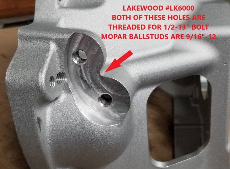

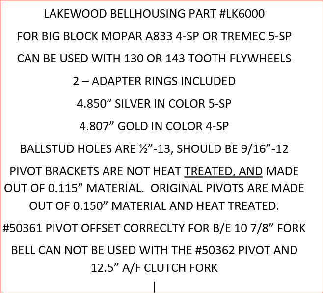

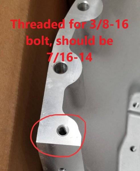

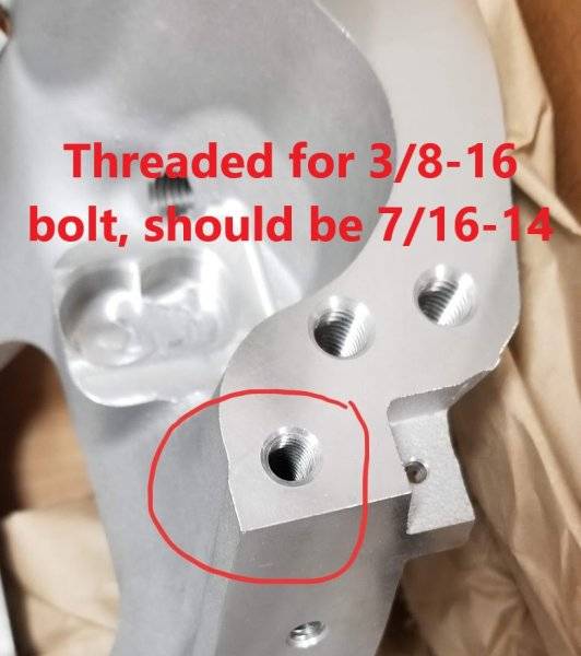

Issues with them
All I can remember is that they had more problems than Quicktime when I was looking for a bell for my T-56. I did have to shim my torque starter a tad on my QuickTime.
