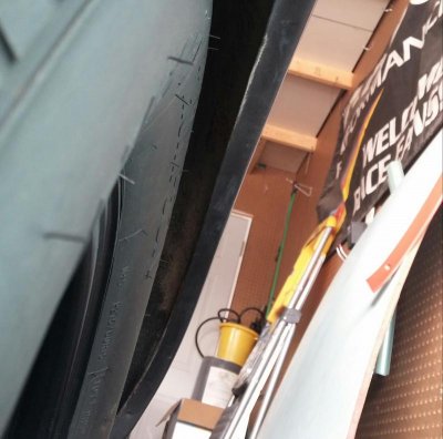

My '63 330 has about 1 1/4" clearance inside and 1" outside.
Tires are Mickey Thompson 275/60/15, rims are 4 1/2" backspace 8" wide Wheel Vintiques and the rear is out of a 68-70 Charger.
