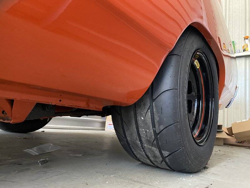

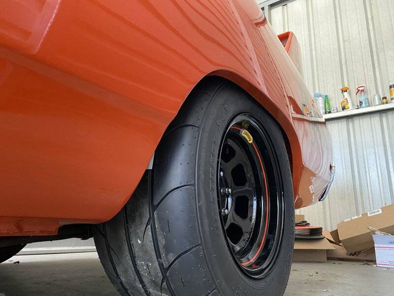

I can't read the tire size too good because it was scraped off on my friends GTX but be careful I think these were 235/50/15 You can barely make out the numbers on the top right of the tire. These were just put on the car and driven a mile to his house. This is a 10 inch wide rim.
In my humble opinion.... a 10"rim can work on a 68-70 bee, because of the more open wheelwell. I DONT think a 10 works on a rr/gtx. It's simply too big.
That tire that he just cut up MIGHT have worked fine on the right 8/8.5 rim.

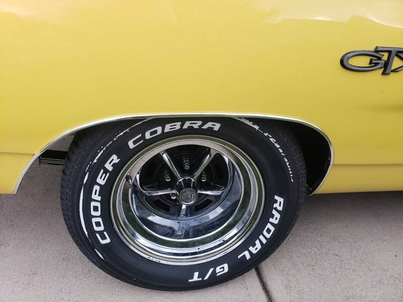

15x7 Magnum 500's up front, 15x8 rears. 225/70 and 275/60 tires....
There's about enough room to sneak your fingers up between tire and fender in the rear.
