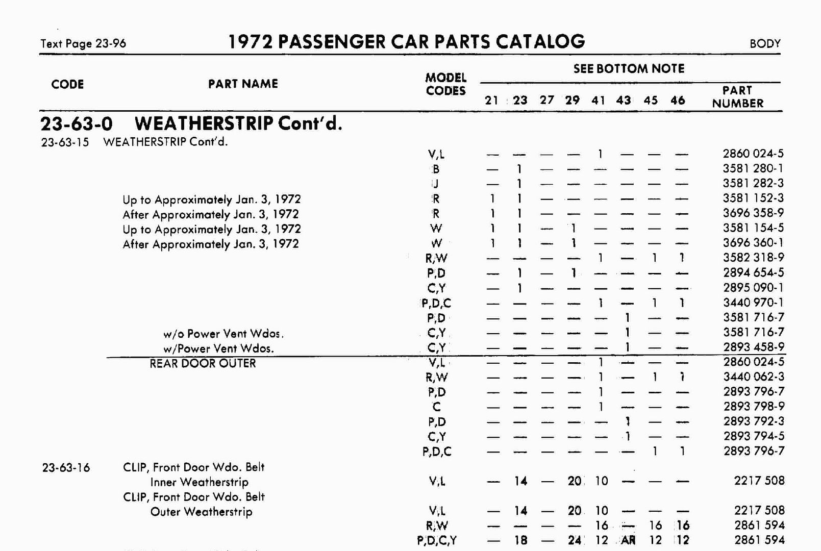

I'm buying some new window felts and need to know if I have an early or late model. Does anyone know how to find out this info and what the difference is between the two? I have a 72 roadrunner.

Moparsteve 636- What constitutes the division between early and late?
Factory Parts books shows a number change for replacement outer door weatherstrips at “approximately Jan 3, 1972”.

A superseded part number is a design change that is backwards compatible, the superseded part can replace the original part/part number. Where a production change is made mid-year, and is listed as different part numbers, before and after a build date, typically are not directly interchangeable for some reason. Not sure would have changed for the outer door cat whiskers, screws vs. clips or screw locations maybe.
