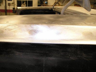

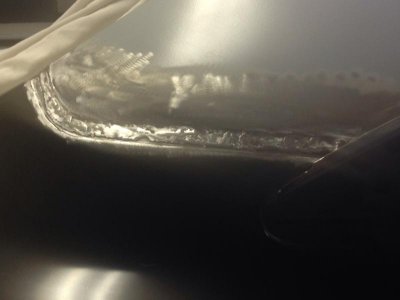

I am getting ready to fill these seams and was wondering what is the best way to go? I have heard pros and cons of both ways.

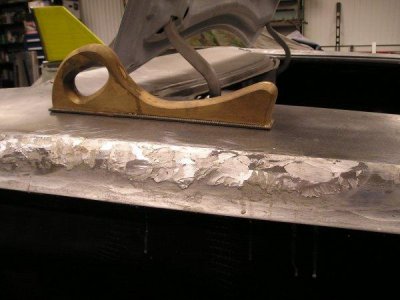

Lead only, don't waste your time with Fiberglass, Bondo or the new crap lead free. Go to Johnson Metal supply. 1/2 the price of Eastwood. You don't grind lead period. Map gas, a few used 1/2 round files, transmission fluid for the files to keep lead out of files and a used Cement flat and your done. Lead does not crack, it flexes and you will need to have the metal white clean.
