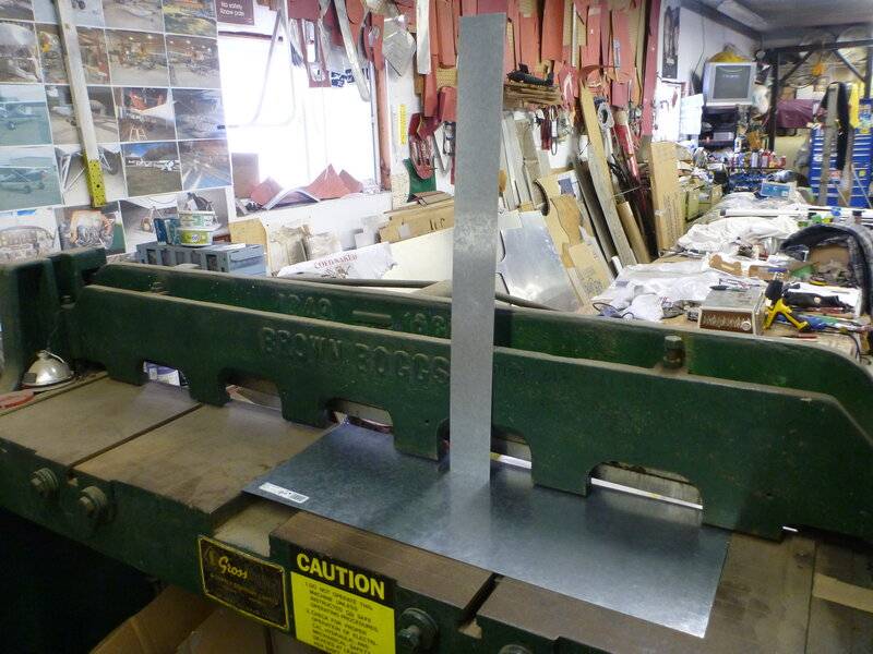

Just shear your own out from galvanized sheet..

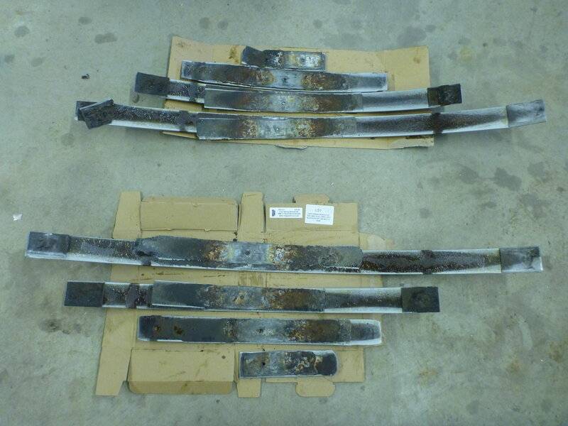

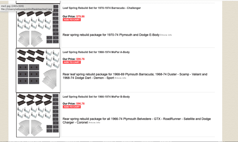

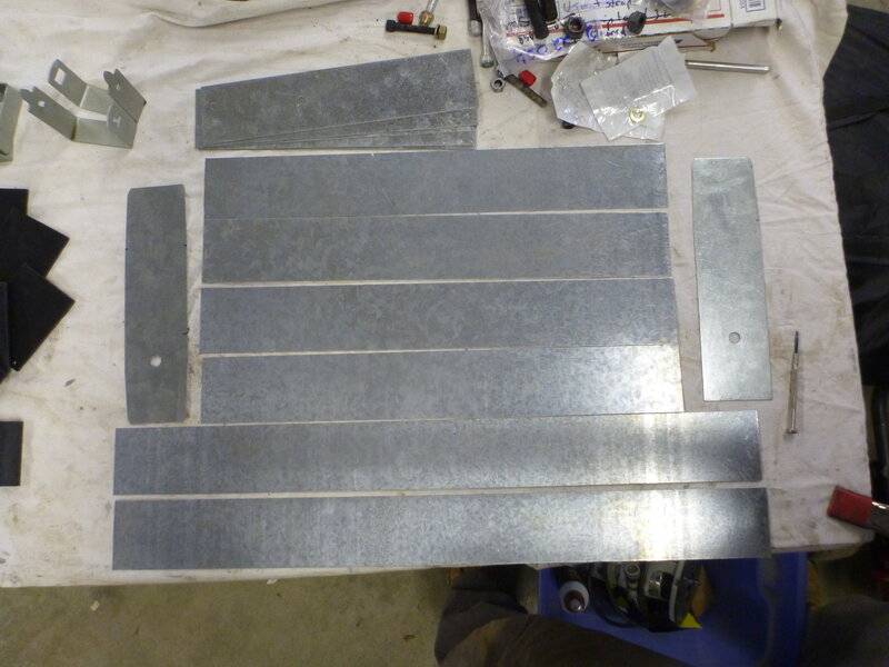

I'm just assuming '65's are the same. My leafs are from a '67 and I duplicated what I took out as the "sold kits" interleafs where a lot shorter than my OE's. SO I sheared interleafs to match and used the plastic wear plates and band clamps from the kit. Trying to remember what the sheet was, but pretty sure it was .025. I'll try to remember to look tomorrow.
