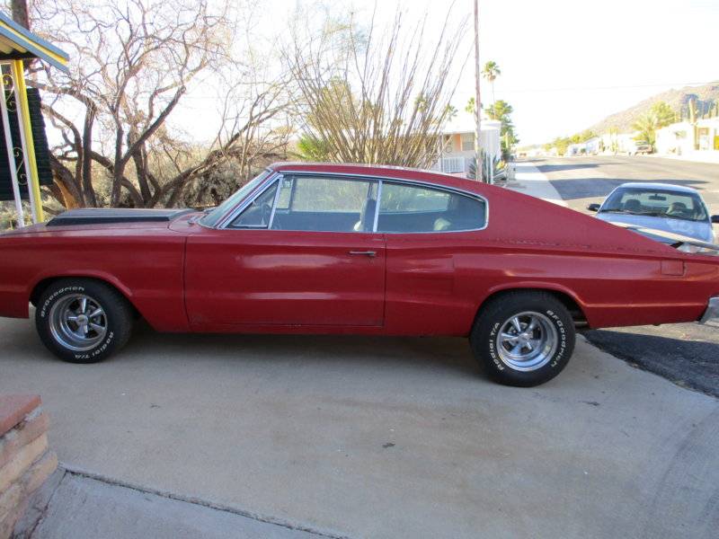

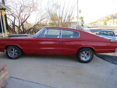

No I can't say I was aware of that. However the pre purchase inspection I had done said that's what it looked like was happening. Along with that it's not a stock 440 so I can't be entirely sure that the leaf springs that are on it are meant to hold that weight. Here's a picture if you could tell me what you think that would be greatly appreciated.
Unfortunately you're parked on a hill and we can't actually tell how the car is sitting. I have a 71 Cuda with gen 2 hemi and I have a slight nose down stance so when I get on it transfers weight to rear. I have Super Stock springs in mine.
Maybe the front spring hangers are wrong, or the springs are wrong, or made incorrectly. Plymouth hangers are shorter. The weight of the engine will have little to no affect on this. The front segment of your springs should be 22 inches long.

That does appear to be a pretty big rear tire on the back. .its a bit hard to tell if you have something going on with the springs. I do know some guys are running a 295/50 r15 tire under the rear of a 66-67 charger but that size does sit pretty close to the front of the wheel well

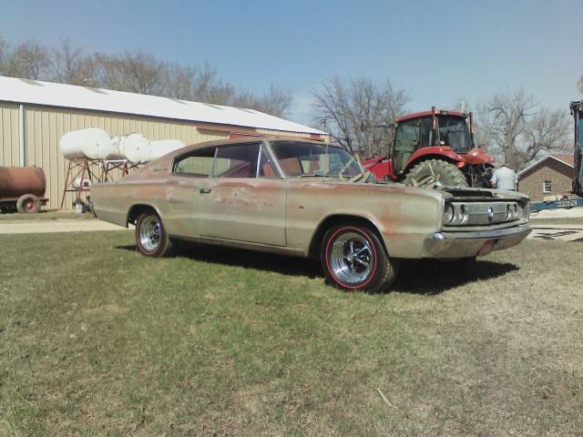

bad pic of my 66. .only one I've got on the ipad, but maybe you can tell that my rear axle appears to sit forward as well. That's factory correct
Actually it would be fairly difficult to swap around parts to create that situation. Your driveshaft would be too long and a few other things wouldnt line up. I think there is no problem there. Thats normal.
