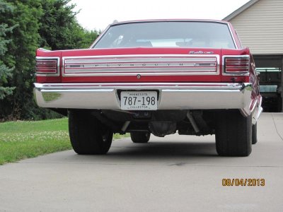

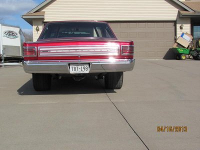

This is my '66 Satellite with 325/50/15 BFG Drag Radials on 10" wheels. Narrowed Dana. Plenty of room for tires. Not sure about the gas tank though, fuel cell in the spare tire well.
Looks awesome, That's what I'm looking to do - I would like to retain the fuel tank though!
