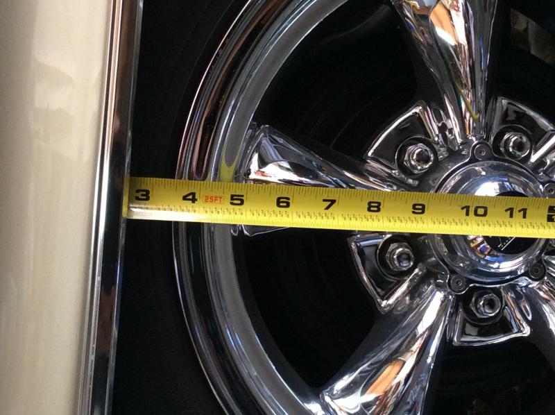

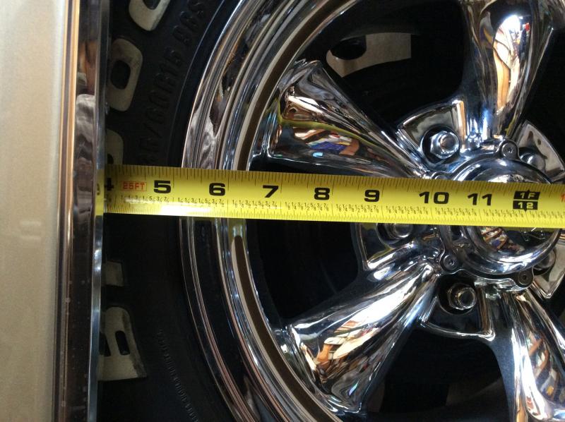

Before with air shocks at 40 psi and og leafs
New xhd leafs kyb shocks n hotchkis rear sway
Overall the lip of wheelwell opening comes about to the bottom of the white lettering on the rear tires
I can't figure which way the iPad will rotate images. My apologies
