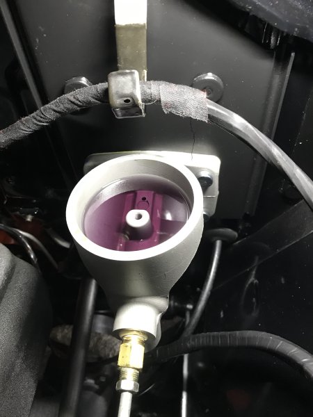

This is a weird one for me. Overhauled the brakes on my 66 this spring and bought a reproduction master cylinder since the bowl in the old one was pretty rusty. The new one had a tapped port in the boss on the bottom with a plug in it that the old one didn’t have. The boss was there but no port. Tightened the plug securely, bled it, put it on the car, bled the brakes, etc. After every drive I would find fluid collecting on the bottom of the boss and no sign of it on the line or upper MC body.

Has anyone run into this??? There is absolutely no sign of leakage that I can find. The fluid just mysteriously appears after a day, sometimes 2 days on the bottom of the boss. The line is tight but even if it were a line I believe I would see fluid immediately after a drive from high line pressures, not a day or two later. No sign of leak from the rear from either MC and it would have to run uphill to get on the boss. I thought about a casting leak but what are the chances of 2 MCs with the same casting flaw? Besides after a couple days I can clean the bottom off and it will then be dry until I drive it again.

I had the same thing with my 66 pot. I always thought it was from a fitting or that bottom boss. Finally it had to be that the cap was weeping slowly down the sides. I sprayed the pot with brake clean to get it perfectly dry and eventually saw the very slow weeping. I cut a new gasket for the cap and added a rubber washer to the hold down bolt. Then I tightened the bolt more than I wanted to because of possible cap distortion. That got most of it but I just can't stop it all. It's much slower now and I just brake clean the master every few weeks.
If you didn't have problem with your original have it sleeved. Is the surface where the cap goes on machined or as cast? Two pours castings don't think so.
I tried to smooth out the master cylinder mating surface for the cap. It needs to be very smooth and clean even with a good gasket.
Fran, it looks well machined. The old one was mostly rusted in the bowl. The bore looked salvageable. I will have to see if I kept the old one. Between the 66 and 67 I have a storage box of old cores.
JonR - thanks. At least I’m not going crazy. I’m going to see if I can find an o-ring and cut a cork gasket for this cap. Hopefully it will seal up. I’m also wondering if DOT5 will show up under a UV light in the dark. If the cap seal doesn’t work I may look with that.
I have the same issue with my 66 Barracuda and 66 Satelitte. Returned the cyl with the bottom port for the one with no port. I found the the original cap seals much better and I don't fill the bowl as full helps also. h

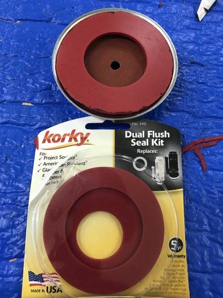

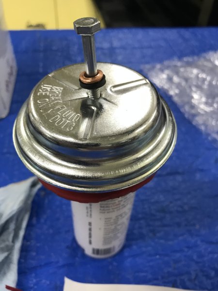

First, here is my next effort considering most likely it’s the cap seal. The MC surface looks smooth so I didn’t do anything to it. I found a rubber flush seal in Plumbing Dept of Lowe’s that requires just a very slight bit of trimming to fit inside the cap. I figure the rubber flapper seal will stay in place better than an o-ring. So installed that over the cardboard seal that was with the cap which I had tacked down to the cap with a thin coat of Permatex#2. And then I put a snug fitting rubber washer under the copper washer on the top bolt. I’ll try to take it out for a short spin tomorrow morning before it gets hot.

I see you're using Dot 5.
I've had the same problem with my dual MC 4 drum. It has to be the synthetic that gets past the cap's seal. Just like synthetic motor oil that finds its way past gaskets and seals unlike conventional oils.
I flat sanded the top of the MC with 400 grit and the seal also. Definitely helped but sometimes I'll find a small amount underneath.
Keep an eye on what you are using for your new seal that it's compatible with your fluid.
Yeah, I have another one I also picked up which is yellow and advertised as chemically resistant. But it doesn’t have as wide a lip. Thought I would try this one first just to see if this is the problem and maybe an answer. I can also cut one out of .062” cork gasket stock.

I braved the heat to run up and down the boulevard a couple times and parked it. Dry afterwards as usual. See what happens over the next couple of days.
So far the MC has stayed dry overnight but I probably won’t declare success until 3 days have passed. I put one of the other flap seals in a cup of DOT5 and I’ll watch it for a few months but I’m a skeptic of all the stories about DOT5 hurting seals. I think the manufacturers are just scared a bunch of people will swap in DOT5 without a complete flushing of the 3/4 out and then have issues - just a CYA move on their part.
