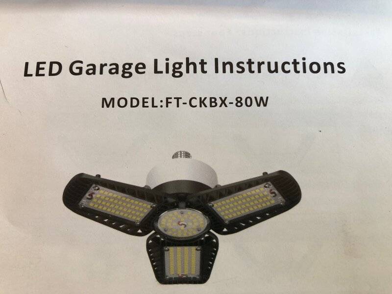

I picked up these garage light that are very brite. I like them but they really create a lot of static on my radiostereo when they are on. Anyone have any remedies other than keep them off.
Try a small ups for a computer on your radio. Should take care of the noise.
Uninterrupted power supply.
They have a battery and a sine wave generator and usually a good filter.
Try a bluetooth speaker and your phone. Use a free app. If you're a Amazon Prime member you get free music with it. There are many music streaming apps available.
I picked up these garage light that are very brite. I like them but they really create a lot of static on my radiostereo when they are on. Anyone have any remedies other than keep them off. View attachment 1010519
