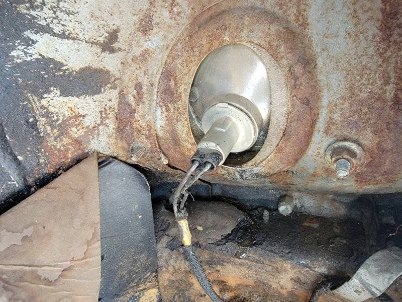

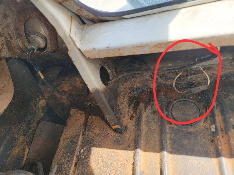

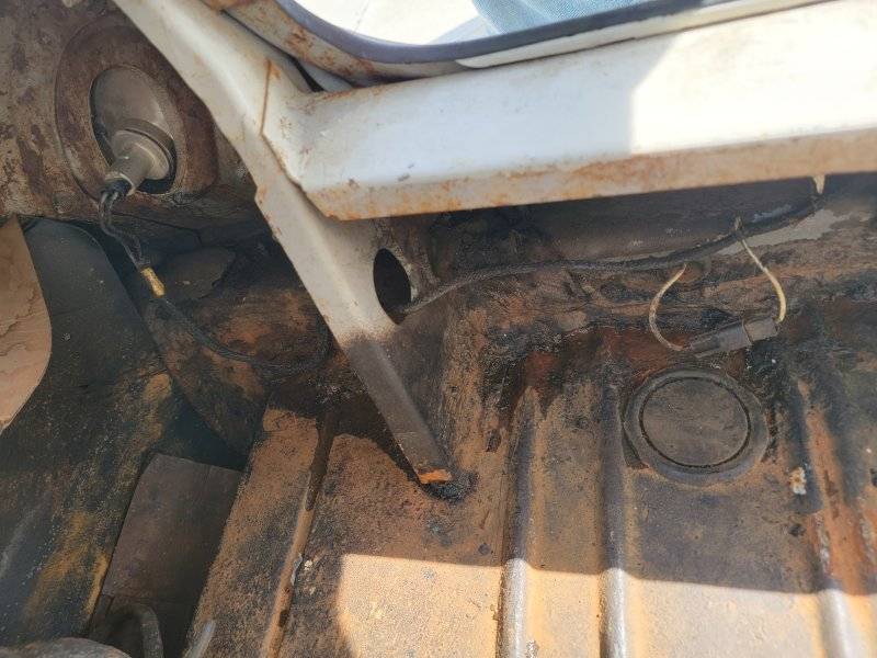

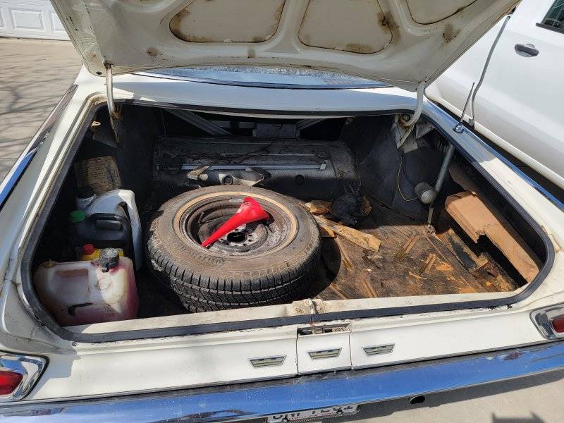

Hi I have a question on upgrading bulbs all around the car brake lights, reverse lights, turn signals and head lights. I have a 1964 chrysler id like to upgrade all the bulbs to LED bulbs, i read somewhere that it will be fine everywhere except headlights? That it jeeds some type of resistor ? .. can someone point ne in the right direction. ... i got sone pics of brake lights i can upload if itll help..
PS excuse the ness i just clean out the trunk there was about 2 to 3 inches of water from all this rain i just finished resealing trunk and vacumming out the water... im working on her slowly but surely...

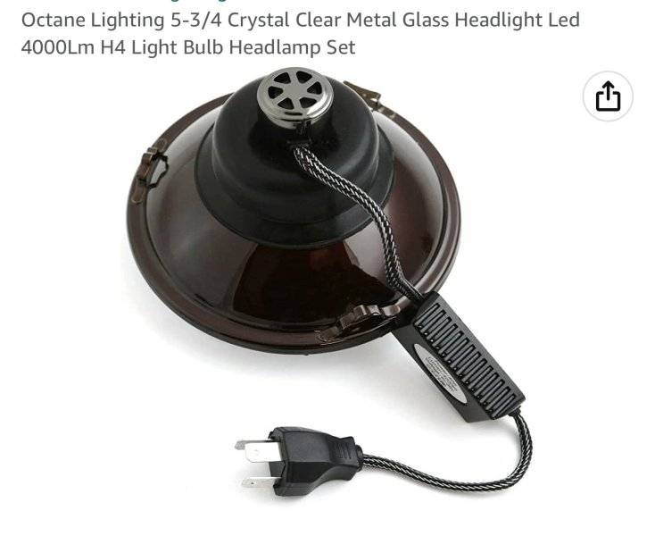

Here’s some LED headlights I’m thinking of going with.
