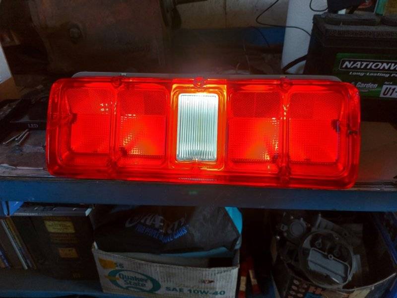

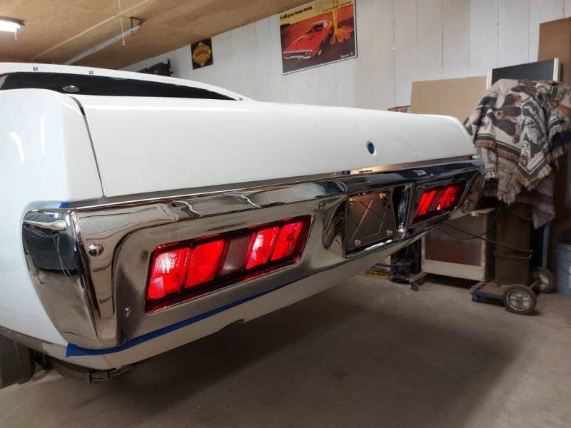

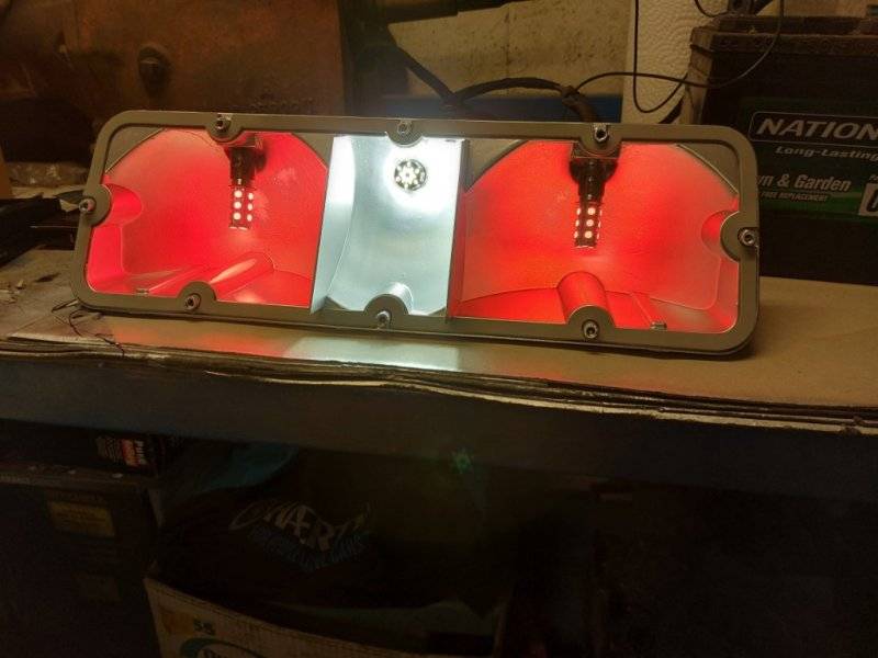

I used these LEDs from Amazon for my tail lights.
These are the red LEDs
These are the LEDs for the back-up bulbs.
Here's what they look like installed.
And here they are on the car.
