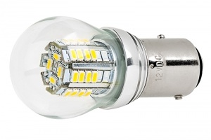

Bruzilla, that is true because the led strips were exposed for a long time. LED technology has been advancing and getting better. I believe they have tried to address that issue with the bulb pictured below. I am guessing they developed this bulb with older cars in mind. I have not tested them out yet, but I like how they are thinking about us.

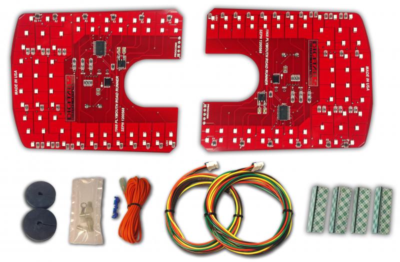

i bought a kit from DIGI-TAILS digital taillights. it came in a whole kit. 2 led panels 4 rubber grommets 1 power wire 1 pigtail tail harness 1 crimp 2 mounting studs and it came with electronic no-load flasher. i am still wiring up the whole car so i dont have it hooked up yet but the kit seem pretty nice. led tails can be switched to solid lights or blink in sequential. comes with 7 page instruction sheet.
PulmcrazyRR Who makes that Bulb you have in the picture ?

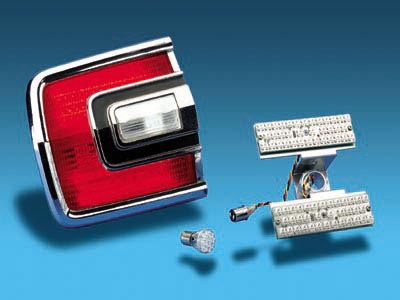

Digi-tail & www.HitechledProducts.com both these were for 68 RR or GTX Belvedere Satellites, I have tried either yet... I will probably go with the 1157 LED bulb & electronic flasher replacement instead front & rear, keep the stock light sockets & housings, too bad someone wasn't repoping the front driving/blinkers & housings for 68-69 B-Bodies Belv. GTX RR Sat., the old ones & used ones, seems they are all crap usually & I wish there were someone/something reproducing them, that was a good replacement, for the whole front Blinker/Driving light assembly....
