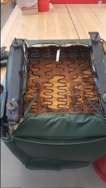

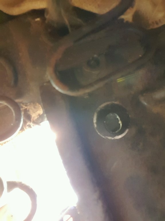

Relocated the brackets with 4 new holes 1 1/4 inches forward. Haven't decided whether I want to grind out the old "swaged" bolts, and use carriage bolts in the forward square holes yet. Leaning toward yes right now. It'll give me another 1 1/2 inches.
I meant to take more and forgot. When I remove the seat again, I will. It's really straight forward. 1 1/4 inches is the best you'll do with drilling. The seat frame changes angles in the back and toward the front. It's next to impossible to go farther because of the spring and frame metal underneath. They make it hard to install the nut. Had to use a mirror and angled hand wrench 1/16 turn at a time to finish the job haha. You can see the nut below the spring and how much forward it is compared to the original hole.
