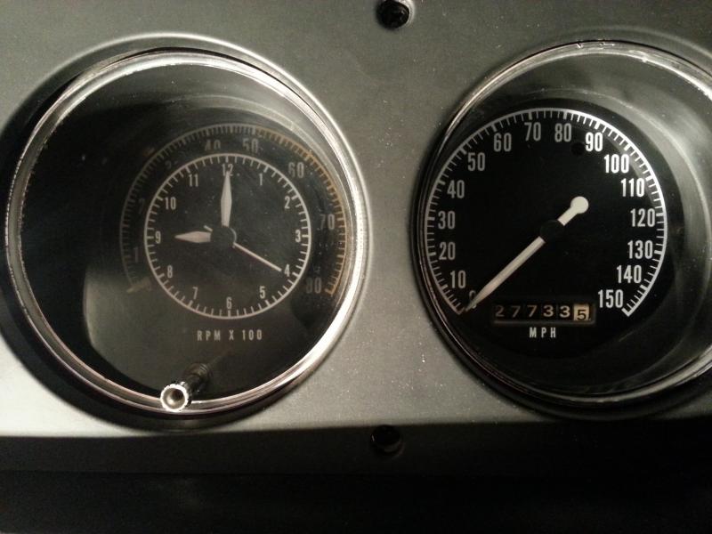

x3 for Plast-x, side by side before and after on my cluster lenses:
