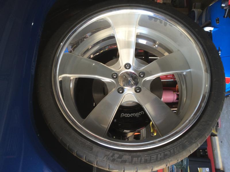

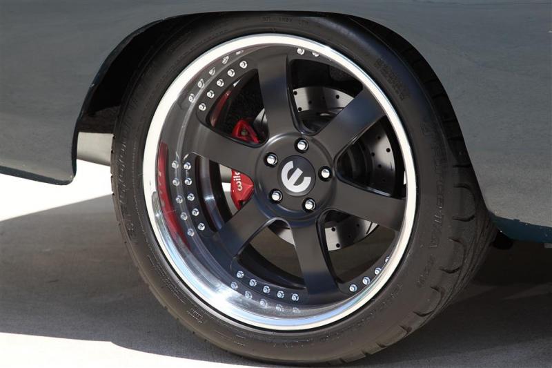

My Charger is still in the build, but I am running 20x8.5" (4.5 BackSpace) Front & 20x10" (5.5 Backspace) Rear Ridler 695 Wheels.
The tyres are Mickey Thompson Street Comp 245/45/20 Front & 275/40/20 Rear.
With the combination of the custom IFS & custom length Moser diff, the tyres fit reall nice front and rear without any mods to the body at all.
I am running Wilwood 14" Rotors front & Rear, With Wilwood 6 Piston Calipers Front & Wilwood 4 Piston Calipers rear.
Everything seems to clear eachother nicely.
Rob.

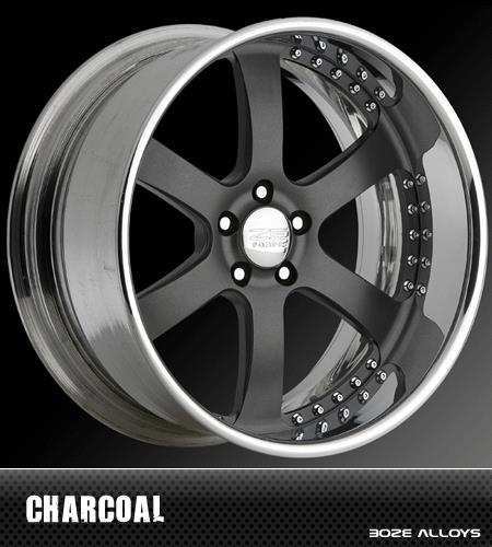

heres mine.
Boze Forged shifters
19 x 10 rears with 5" BS - Bf goodrich G force KDW 2, 295/35/19
18 x 8 front with 4.5" BS - BF goodrich G force KDW 2, 245/40/18

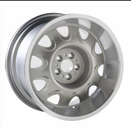

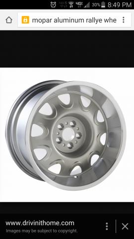

I really need some help. I will have the aluminum Rally wheels (see pic) for my 70 Dana 60 equipped Roadrunner, but what I need help with is the wheel and tire size and offset that will allow the widest patch of rubber in the stock rear fenderwells, and can I get them to match the one pictured if it is some kind of special "custom" wheel. There are a number of outlets for the wheel pictured, and they come in 8" or 9" with 4.5 or 5" backspacing. If that doesn't allow for the most width inside the rear fenders, where can I find an identical wheel in the right size and what is that size? Screenshot_2015-05-10-20-49-35-1.jpg

68-70 dodges i know you can fit a 12" wheel in the rear and a 10" in the front max. for safe distance 8" front and 10" rear. with no body mods.
305 tire will fit in the rear but 295 is safer.
roughly 5" backspace for the rear will give roughly 1" gap each side of tire for a 295 tire.
best to get some measurements before you order, some of the big wheel companies ahve a measuring sheet you can use
If you want to be sure, but the Percy's measuring tool...
yeh good idea too, I have a percys wheelrite, only problem is it does not simulate the tyre very well as it uses a piece of wire
I will see if they already make a 10" version of this wheel. If not, I may just get the 9" 5"backspace for the rear, and 8" for the front (not going too wide on the front anyway) as I am looking for that overall appearance. Thanks a lot! If that isn't wide enough, I will have to consider having the rear wheels made to copy that look, and mini tub (or tub) the rear with some plan to relocate the rear springs and possible 4 link setup. I am more focused on a straight line performance look and result. Thanks again!

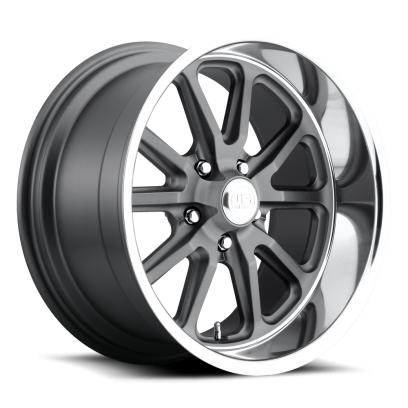

alright I've finally made a decision and bought my wheels...no tires yet...going to wait and see how much room is left...I went with 18x8 & 18x9 1/2 so we'll see how she turns out fingers crossed...they are US Mag Rambler and they were $900 a set...

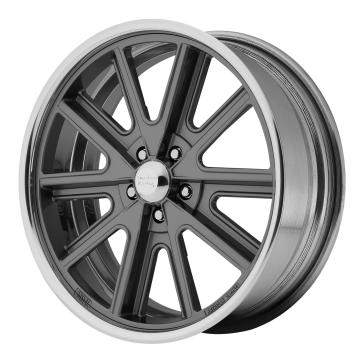

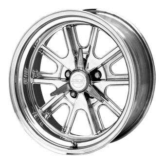

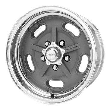

I really like these two styles of wheels from American Racing
mine if I go to this style will only be
17's x 7-8" [? 4"-bs] up front & 18's x 9-10" [? 5"-bs] out back
I want to still keep some sidewall & a somewhat vintage 60's look too
1st choice
Bonneville VN470
http://www.americanracing.com/wheels/VN470/VN4704
Shelby Cobra polished
{not sure I want the polished or not}
http://www.americanracing.com/wheels/VN427/VN4271
2nd choice
Shelby Cobra grey centers/as cast
http://www.americanracing.com/wheels/VN427/VN4073
I like the wheels I have now too, just thinking about going larger diameter
they are 15x 7" {4"-bs} 245/60 & 15 x 9.5" 295/50 {5"-bs} Edelbrock/Halibrand Kidney Knock off

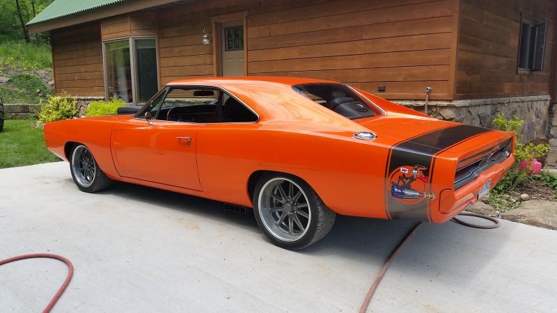

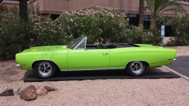

Nice choice!!!!!!!!!! Here's my Charger lowered 2" with US MAG RAMBLERS 19 X 10s out back and 18 X 8s in the front, zero offset on both.
