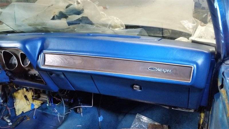

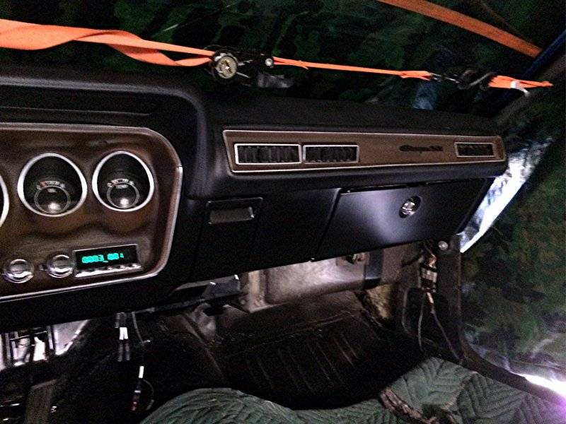

My '74 will be a very nice DRIVER quality car when totally completed. I got my Dash Cap from 1A Auto (around $125 back in 2017) and I am vey happy with the outcome. Here are a few photos
View attachment 1465472View attachment 1465473View attachment 1465475
That looks phenomenal, I’d be very happy with that.

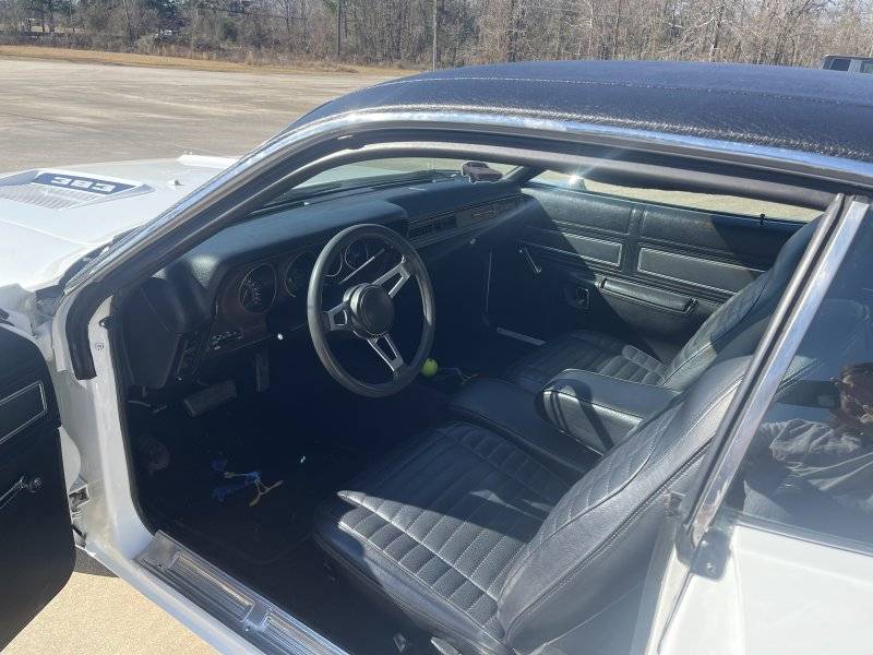

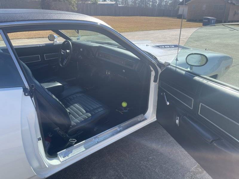

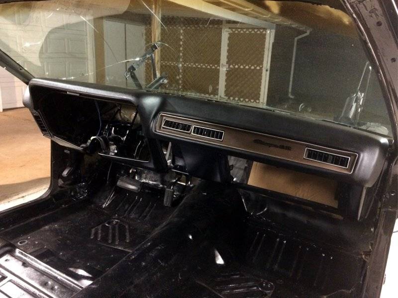

I used a Repo dash pad from ABC moparts. Fit fine. Installed in 2015 It has held up fine so far. no cracks, or warping. We get pretty intense sun exposure here. Alot more work to install a new pad but I think it is worth the effort.
I used a Repo dash pad from ABC moparts. Fit fine. Installed in 2015 It has held up fine so far. no cracks, or warping. We get pretty intense sun exposure here. Alot more work to install a new pad but I think it is worth the effort.View attachment 1465653View attachment 1465652
That looks great. I’m in Albuquerque, and like to drive the thing to work where it sits in the sun all day, so sun tolerance is a big concern.
I think I’d rather have a new pad, and the dash will be all apart anyways, just was afraid of any fitment issues.
If your taking your dash all apart perfect time to do the dash pad. The nuts on the driver side corner, and passenger side corner are the only tuff ones to get to to remove the pad

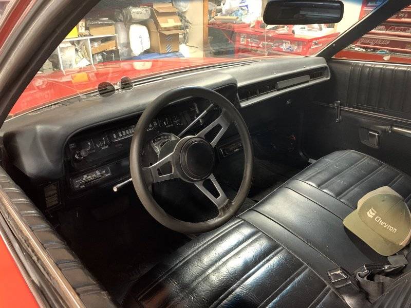

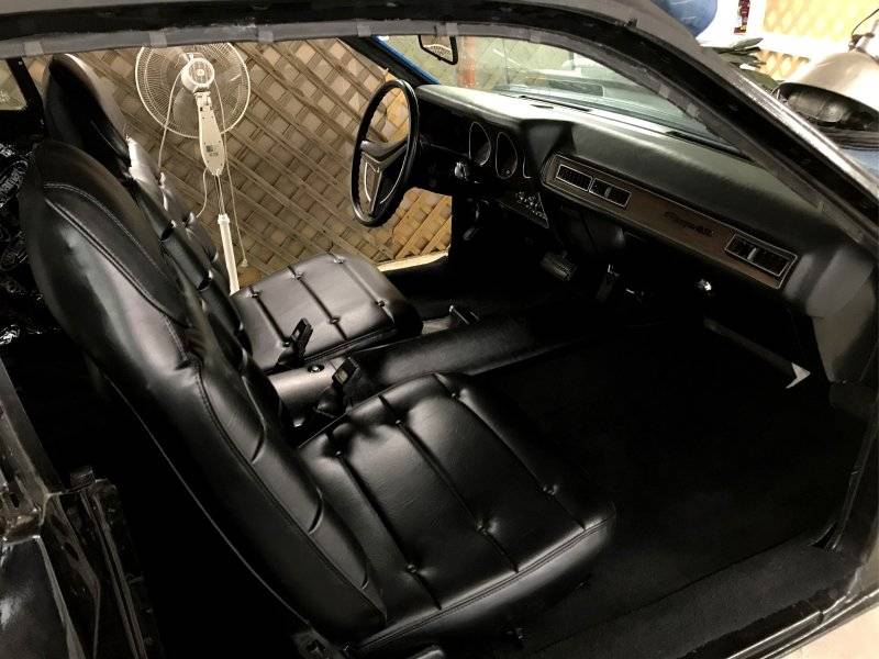

Only experience I have with dash pads is the one in this roadrunner I bought with the interior already restored. Previous owner says it was from Just Dashes. Best pics I got.
And when I say restored I mean about 12 or 15 years ago.

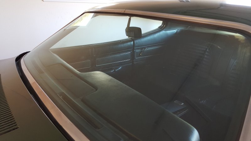

My 72 has a cap and it looks pretty darn good until you get right up on it and notice the grain is shallow.
Who ever installed it did a good job.
