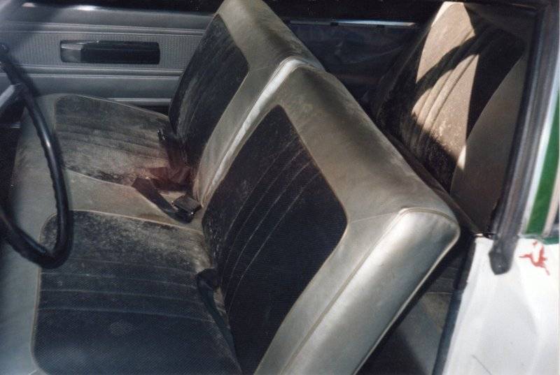

My "silver special" 4D Belvedere parts car does have black visors and headliner.
Sorry, mine is a 67.

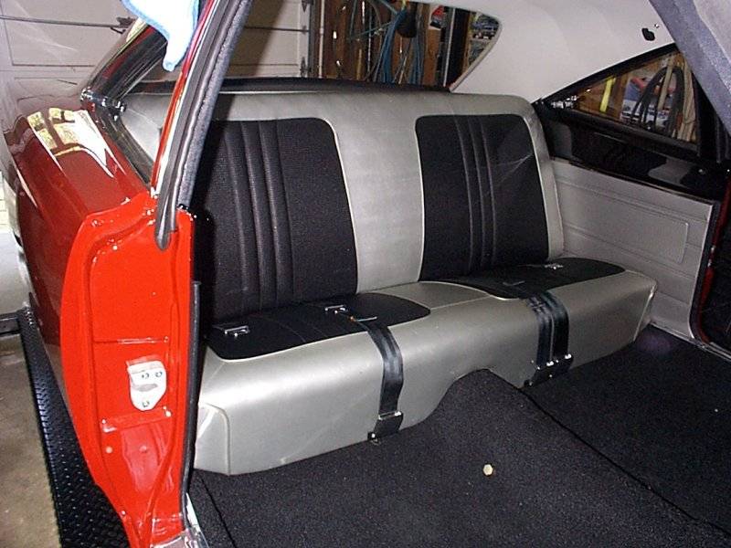

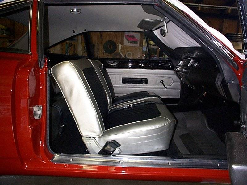

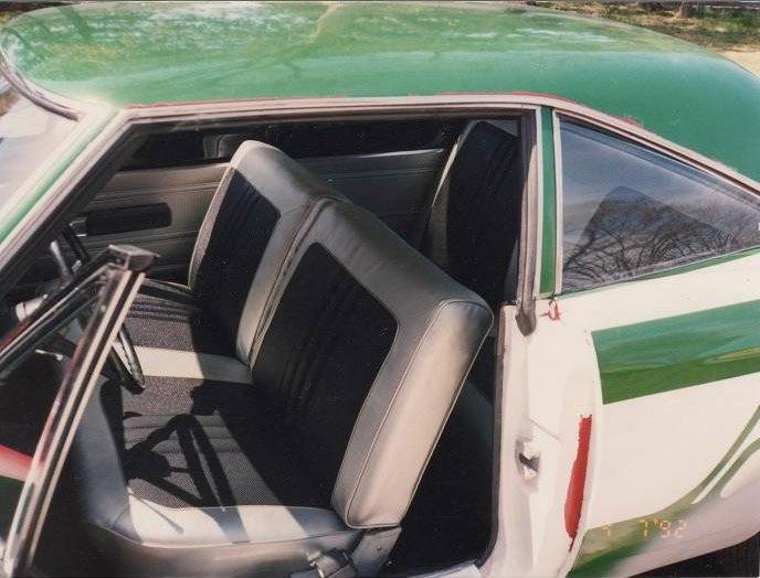

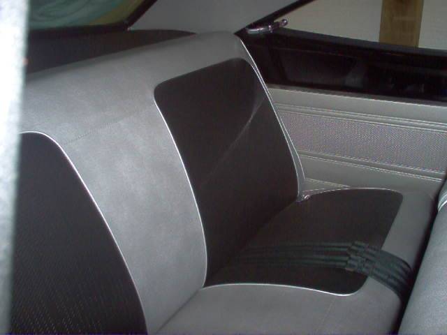

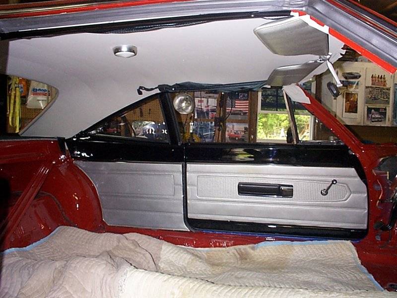

My 68 Road Runner has the D4S interior. I got it as a 10K ex-race car over 30 years ago. Yes, the headliner and visors are silver. I inquired at Legendary maybe 25 years ago for the silver headliner and was told that they did not carry it. That silver material was also used in 67 on some VIP models. They did pass on some information that I followed up on - They knew of an auto interior shop in LA that could help me. Quite appropriately the shop was named ACME Upholstery (Los Angeles area maybe) and they had some NOS material in that color in stock. They made a headliner for me but it was expensive, seem to recall it was about $400 vice the typical $75 for a Legendary item. But it was well made. The local guy who installed it asked where I got it because he could tell it was not a China item. When I told him the name, he said that they were known in the industry for doing high end custom work. He felt honored to work with it... I have no idea if they are still around or not. Most people with the D4S will just install a black headliner out of convenience, and probably the same with the visors. Other items I see substituted are the arm rest bases (should be black), lock knobs (black) and rear window plastic trim (silver). In these pictures, the door panels, seats, visor, arm rests are all the original stuff. The pictures with the green paint and dirty interior are from 32 years ago.

Thanks Jim! EXACTLY what I was looking for.

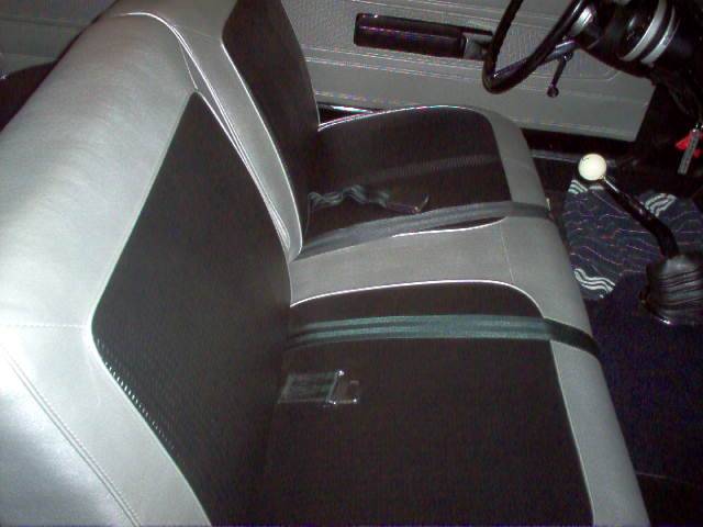

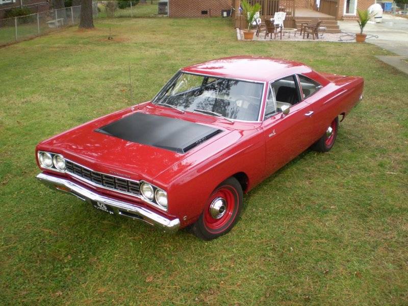

Seat inserts for '68 were Reed grain pattern without pleats. Silver visors & headliner.
Fun fact: Legendary used my original '68 interior to make the Reed dies and patterns 40 years ago when only the '69 inserts were being done.
It could be that late-MY-1968 got the pleated inserts, as the flat Reed inserts could stretch.
My car had black garnish @ back window. 9/30/67 SPD St Louis car.
Shift lever is not correct in my car; I did that when I went with a Hurst shifter.
