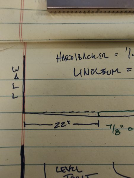

Toilet is about 16" from exterior wall. Cast iron pipe, not moving it. Floor drops 7/8" within 22" of the exterior wall, then levels out. It's the joists - they sag in the first 12-18" from the foundation, and level out. Old house (1952).
