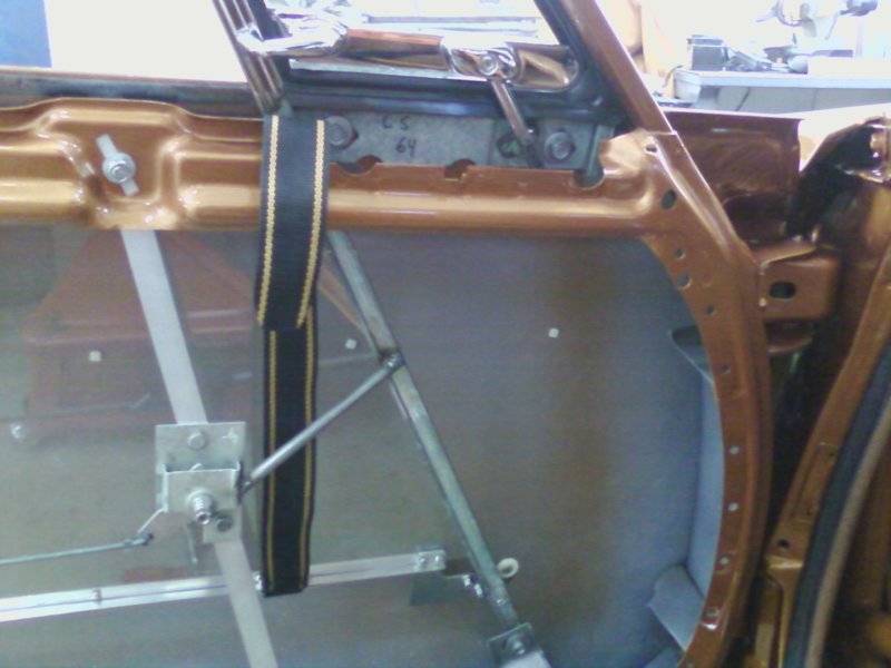

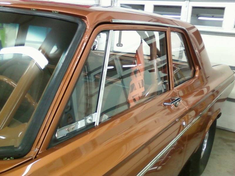

I cut mine from 1/8" Lexan. Vent windows are 1/4". Sand the edges while the protective paper is still affixed. This will prevent scratches. Makes the edges look factory. My doors are gutted. But the channel is still there to hold the window. Backlight window is in the stock rubber seal.

DougView attachment 892222 View attachment 892223
Very nice and clean looking! At the bottom of the window is that just a piece of aluminium stock? The front a piece of window channel? I just built a new garage and got my lift installed but no welder yet or any other fabrication tools so doing it on my own may be a bit of a challenge without investing in some new tools.
The bottom is .060" 1/2"× 1/2" aluminum to stiffen it front to back. The roller on the vent assy is a modified closet door roller from Home Depot. Window strap is from a plastic battery box. The inner handle is bolted to 3/4" x 3/4" 1/8" aluminum. All hardware holding it together is #6 machine screws and nylock nuts. Lexan was cut out with a 20 year old Craftsman jig saw. All done with hand tools. Except where I stiffened up the inner handle mount. Welded a 3/8" piece of steel fuel line tubing between the vent frame and handle mounting plate.
