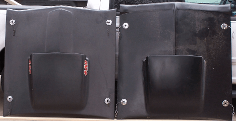

RR on the left. SB on the right.

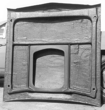

Original underside looks rough and unfinished;
Repro underside looks smooth;
Hope this helps.
