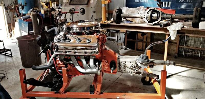

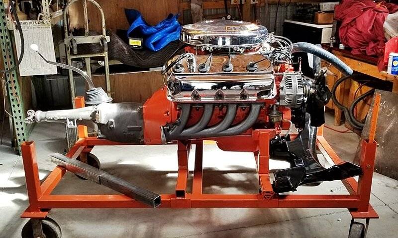

Hello all... I have a harbor fright lift I bought about ten years ago and its strapped to my heavy duty steel 2000 #table on special HD castors for movement.
I really like this type for lifting setup... a cherry picker takes up to much floor space.
According to the manufacture of the lift its rated for 1000#s
I am assuming that rating is the steel tube boom and cable.
I does anybody think 1200#s would be stretching it to much?
I have 800# hemi on it as the picture shows.
Whats the general consensus on the Lifts ratings.....?
Thanks to all who participate in this thread..

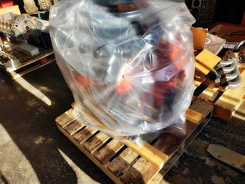

I just don’t know what you’re going on about but I do know the best way to rust the inside of a new engine is to wrap it in plastic

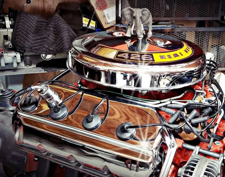

The picture was taken just after the dyno a year ago....
Here it is just before taking it home with the plastic ........:>)
The engine looks like this ever since....last two pictures but covered with two wool army blankets.

FWIW, I would think the cylinder should take it. The weldments are likely the weak link. Also, it looks like you are applying force right to the center of that mast tube. Maybe check the opposite side with a straight edge and see if it's deflecting with weight. You don't need a kink starting there.

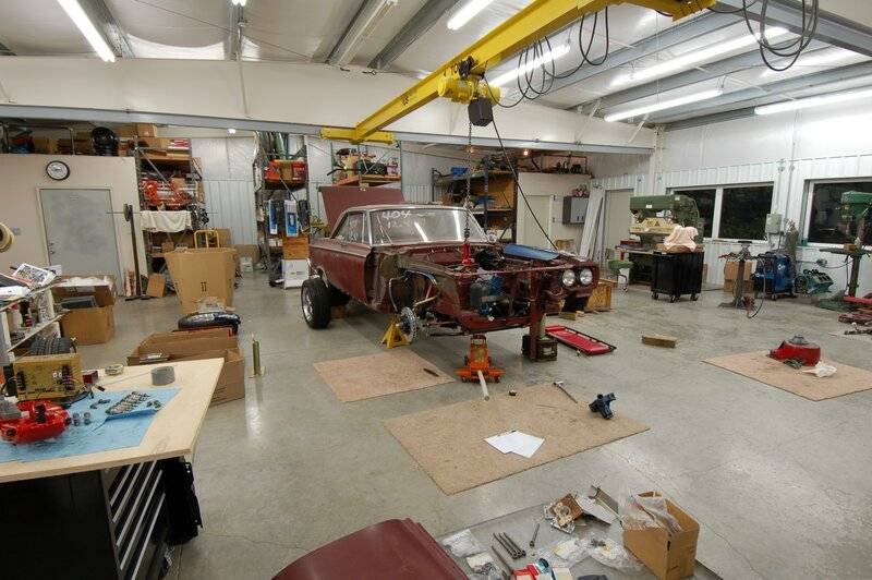

I have a one ton bridge crane in my shop. I don't tempt fate, I keep the load under the rating.

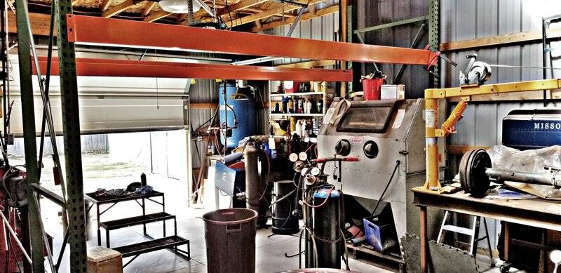

First off the lift was meant for a pickup bed and not a cherry picker.
The pick bed could only hold maybe 100 lbs before crushing the bed floor.
I cut the heavy rotating tower holding the boom down so there was no leaning one way or the other.
1/2 bolts to a half inch plate table 10X5 with heavy duty castors for easy mobilization of table
I cut a shim so there would be no slop (critical) it rotates smoothly 360 degrees.
like i said 1000 lbs easily.
The crank handle could be extended another inch or two
Used it to lift my Dana rear end
The base is fortified enough as it is seen i picture below.
They $160 at HF

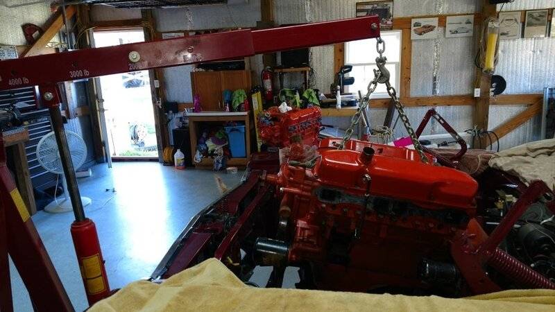

The big-arse cherry picker I have is the type where the legs can be lifted and pinned back into the
uprights, where it then can be stored against any wall pretty much flush.
In my case, it tucks right in beside one of my 8x8 columns and is never in the way.
It may be Chinese, but it supposedly has some serious capacity.... :)

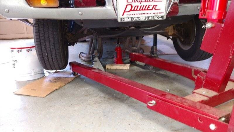

For what I need (occasional engine removals, car lifting from an end, etc.) it does just fine,
especially for the money AND for the peace of mind.
What limitation? The fact you can move it around and into place?
Putting my offshore wonder (Not the Dutch woman) to the test lifting an A833 and a few other things!
