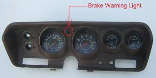

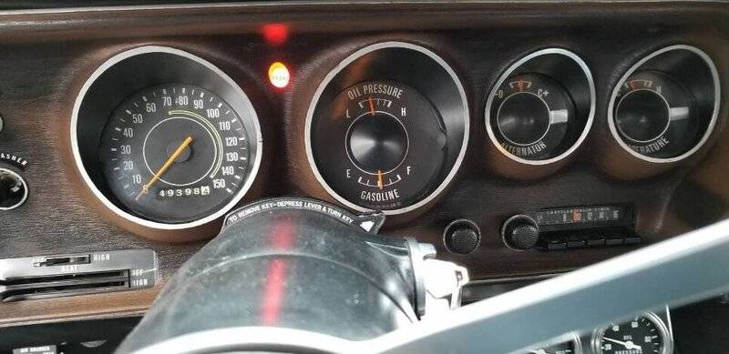

What is the light between the Speedometer and tachometer? It's a small round light. Looks like maybe a red lens should be in there? It's missing, and it's bright and doesn't turn off.
This light here. The one that it lit up.
Brake light? Fasten Seat belt light??
I am pretty sure that is a brake light. Check the emergency brake or look to see if the proportioning valve switch is stuck.
brake warning light

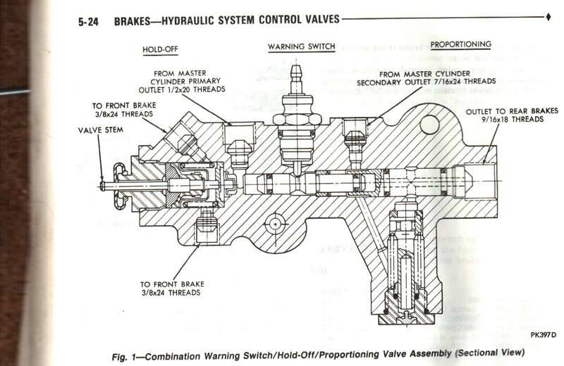

Not stuck, but with some pressure diff between rear and front brakes system ( such as a leak ) which will move a double action piston to activate the switch on brakes dist block.
