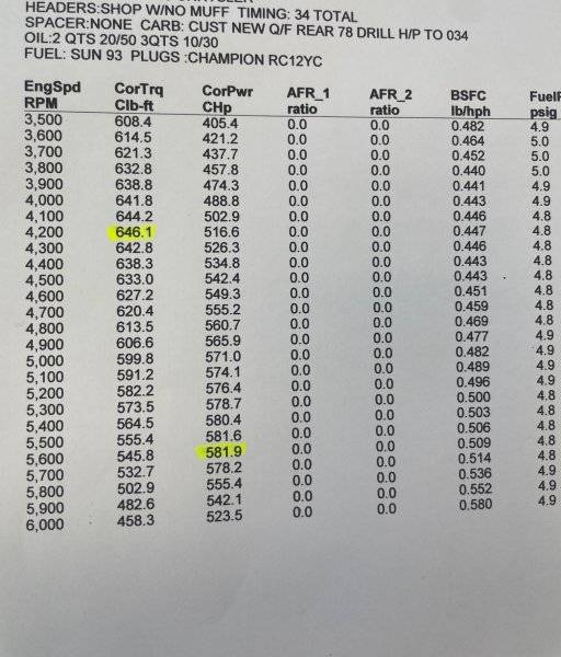

Lil ol 383 back from the Dyno

Just a stock 383 right? :)
That curve looks a whole lot like my 400/500 stroker. Did you happen to leave out a few details:lol:
440 Source Kit to 496ci with TF 240 Heads and QF 750. Side Note- the folks at the Dyno shop were very impressed with the Progressive Ignition Distributor-the adjustable timing on the fly, immediate read out were all what i have heard. but his comment was from a safety side in that he could read the timing during pulls from behind the glass vs. leaning over an engine (that he may not know the details of) with a timing light!

What bore are you running?
I see trick flo recommends 4.350 with the 240 heads
Thanks
RD- 4.25; I was concerned there as well, but all 3 (TF,440Src and Builder) did not have issue with this.
