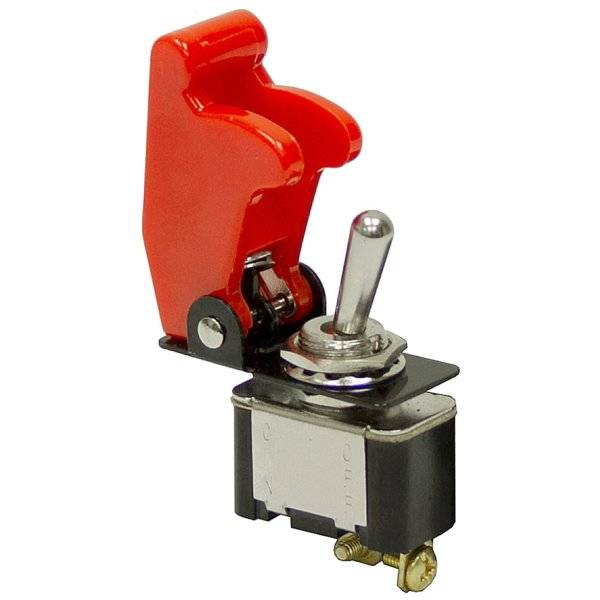

You don't need to use a momentary switch like the one they give you in the kit. Any on/off switch will do. You can mount it anywhere you want. They make switch covers you can use on the switch also.Just make sure that it doesn't get turned on while you are driving accidentally.

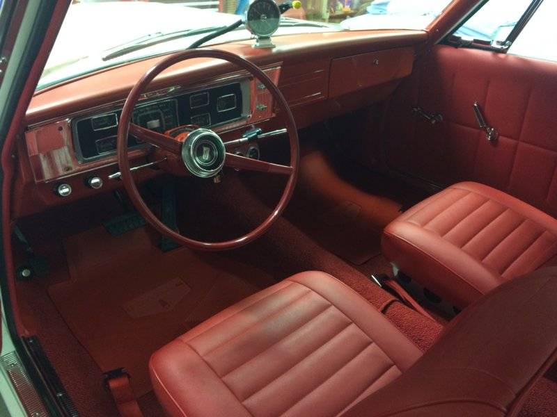

Clean interior 65Hemi..

My 63 Plymouth still has the push button trans so mine is on the turn signal lever.
