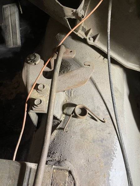

My cars a 73 Barracuda,can’t log on to the e body site ,anyway anyone have a picture of the spring install on the floor shift linkage it’s the fwd where the rod goes down through the floor ,my book is a 70 can’t find a picture thanks
My cars a 73 Barracuda,can’t log on to the e body site ,anyway anyone have a picture of the spring install on the floor shift linkage it’s the fwd where the rod goes down through the floor ,my book is a 70 can’t find a picture thanksView attachment 1557151

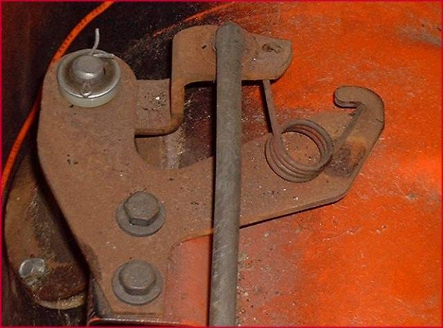

The right angle end of the spring goes in the hole in the linkage and the hook on the spring goes in the hook in the bracket.
