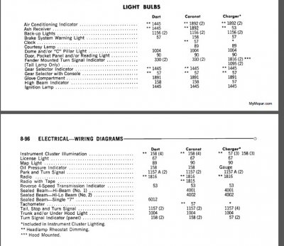

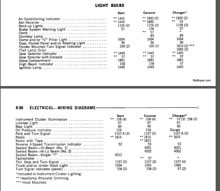

Hi,
I'm replacing bulbs for my Super Bee and is looking for a specification list of the bulbs that are being used.
Did search the forum, but couldn't find a list.
Is there any list out there perhaps?
This one seems common:
http://www.bulbs.com/product/1157B2
Here ya go...
Download your service manual HERE:
http://www.mymopar.com/index.php?pid=109
And lots of good reading and resources too:
Classic Industries has it in the back of their catalog also.
