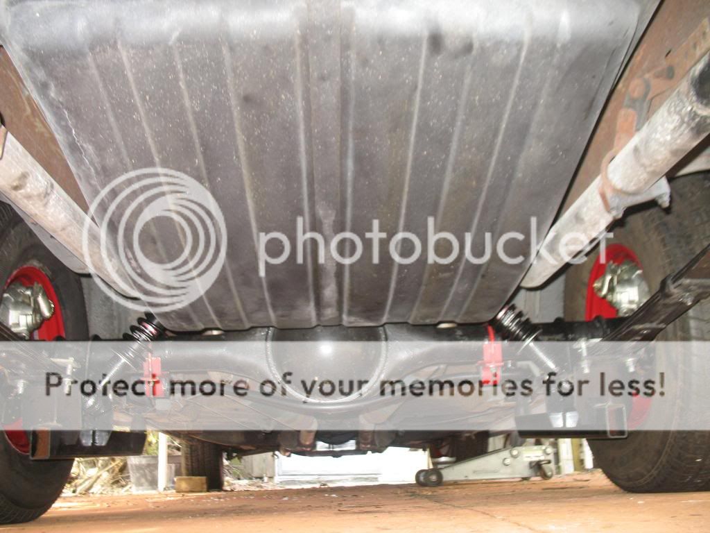

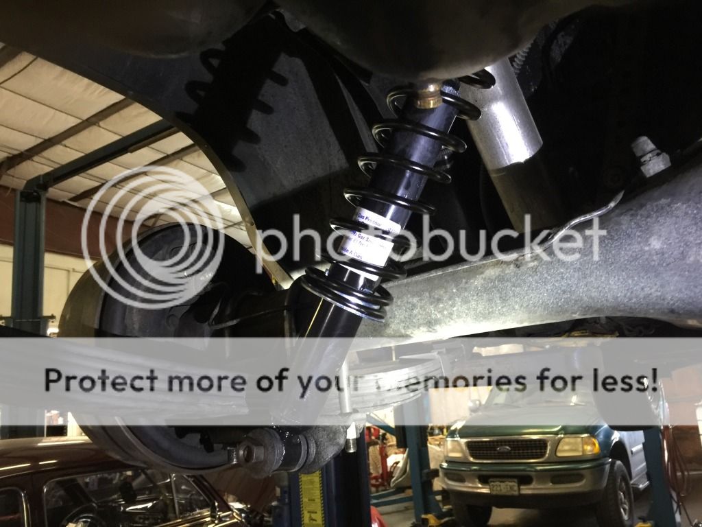

Anyone use coil over rear shocks ? Thinking about them for my 69 Roadrunner
no replacement for sold leafs but i got some for clearance/ a little lift
I don't see them but there people out there that say oh no!!! if it works and it's reasonable price do it !! they're on my 65 satellite and the stance looks great!!

No one is going to bad mouth these when then bad mouth air shocks?? What's the difference in using air shocks with around 10psi vs a spring/shock combo that is probably equivalent to 20+psi?? The down side to air shocks is when someone jacks the car up with more psi but I've had excellent results using air shocks and you can adjust the height real easy. I don't see anything wrong with the coil overs either so long as your upper shock mount is in good shape and is welded in good from the factory. With air shocks, you do need to use a separate lines kit....however, the best thing would be to use a set of leaf springs that put your car where you need it.
