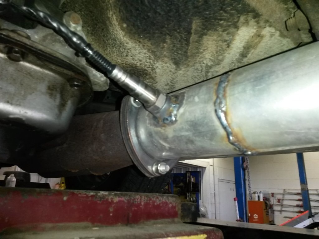

this is where I installed it, 24" from the stock header outlet
Hey Runner,
Do you have a question? From my reading I found recommendations to keep the O2 sensor in the header collector(close to heat) for best readings.
Mike LeFevre
No, I actually just wanted to be the first to post in this area! Seriously though, the EAM installation guide recommended 18-24". I will take some temperature measurements soon and post.

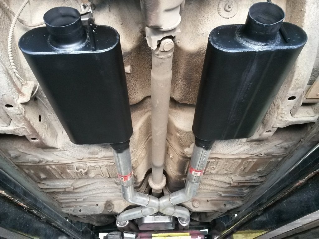

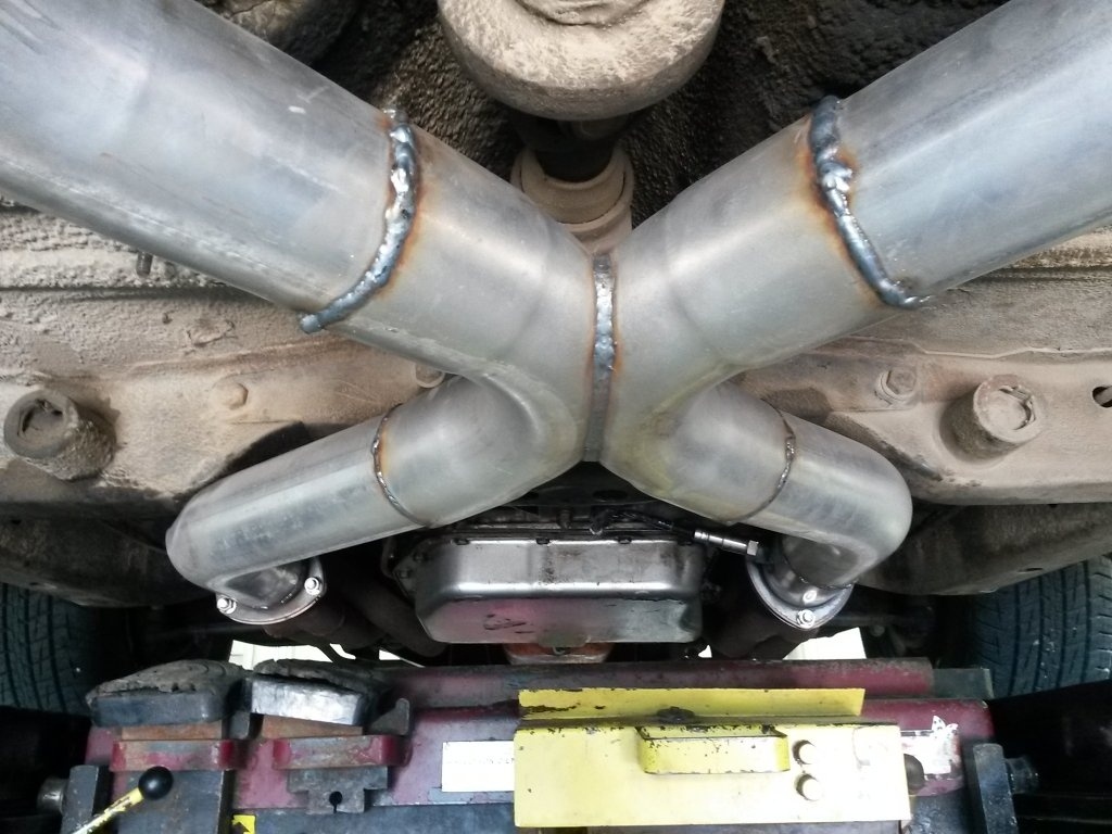

Here is where mine is. Recently installed a generic Summit 3" Xpipe.
