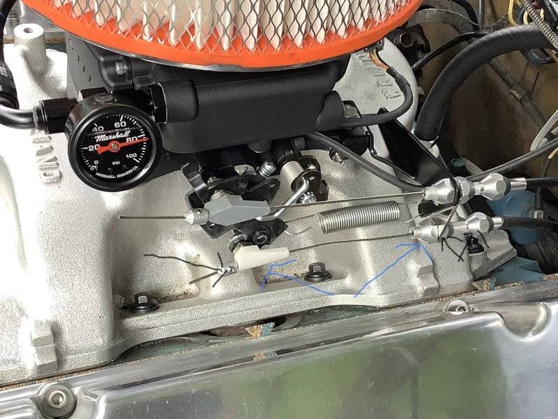

Adjust the cable and housing length, and also you can adjust the length of the cable. If I remember correctly the stroke has to match the same distance as the throttle so at wide open throttle the lever is just at the end of its travel on the transmission. Very small adjustments make an immediate difference in shifts and down shifts. Test and tune is the fun part.
I tried to outline the adjustments in this picture, you can see that there is plenty of cable length which is important. Make sure you have extra cable length.
