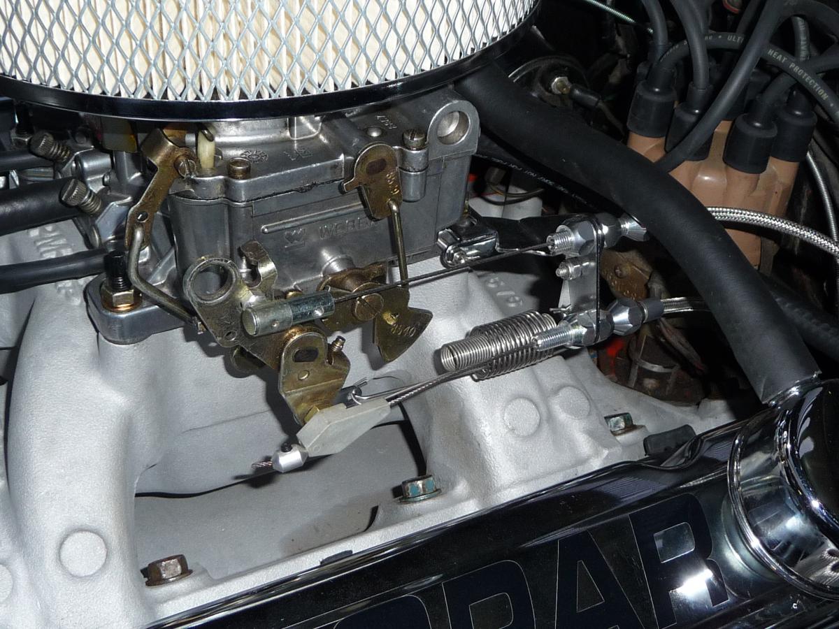

Corndog, as promised, here is a picture of the linkage kit I bought off ebay for the mopar 904 trans. Considering it doesn't have Lokar printed on it, I would imagine that it's a reverse engineered knock off. However, I'm into week two of taking the occasional cruise and I haven't had any trouble out of it since getting it adjusted properly and am happy with it. The kit came with throttle and kickdown cables, mounting brackets, springs and other fittings. Mounting the kickdown on the trans was probably the most difficult part and only because of the space to do the work in. I didn't have to cut anything on the kickdown, but I did have to trim the trottle cable and braided steel tube to fit. Hope this helps.

Thanks for the picture! I really like the clean look of that. I've seen that kit before but I wasn't sure if you got the same one (seems like they have to choose from). So it's a knock off kits just like Lokar? I'll have to check out eBay and see if I can find it. Thanks again!
