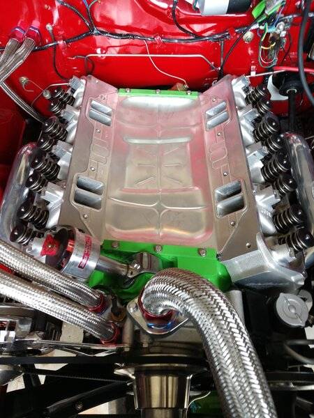

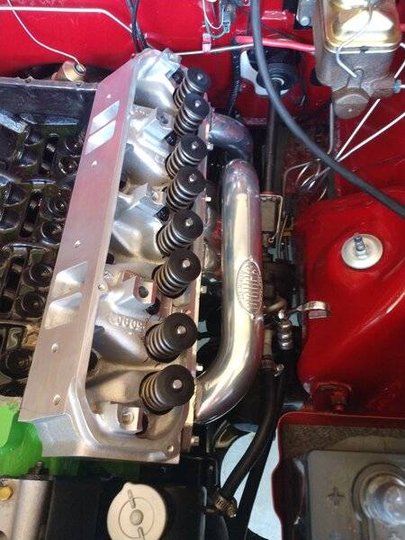

I just put a set of Doug's D452 headers on my Charger yesterday along with a set of Edelbrock RPM heads
The fit is perfect! I have never installed a set of headers that didn't need a ding or two.
No clearance issues and the finish looks great
The price is almost 400 less than the TTI
Still need to refinish the intake and install the valve train but I am very happy with the headers
