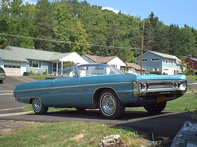

Thanks, good to know, that's helpful. Sounds like same kind of rust areas in general to look for that my 4 fusey Furys had. (pic of my last one). Even SW cars seem to have those problem areas. As it was for sure a driver here I'm sure this has plenty of rust but it's about potential to restore without a complete body take apart that I'm going to be looking at. If too far gone it'll have to be someone else's project.
my '70 F3, now gone.
