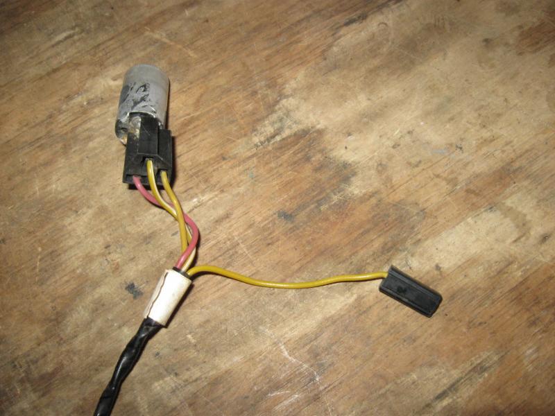

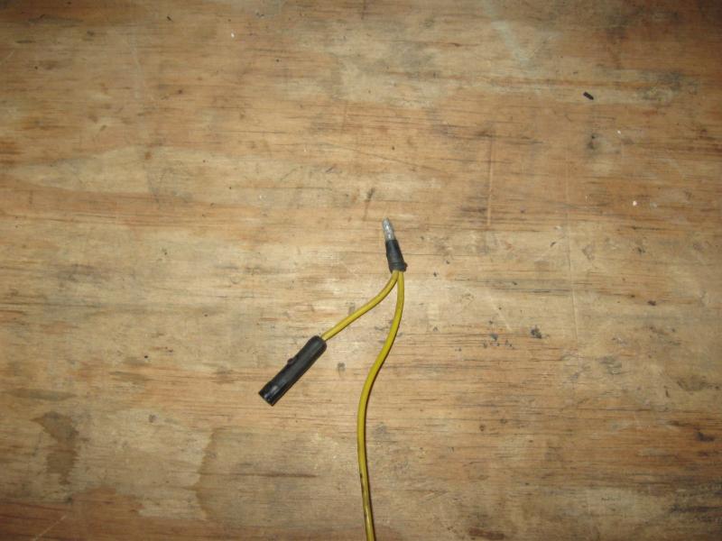

i can not figure out where these yellow wires and connector mate up to? second pic what plugs into that connector? see pics. this was not connected. this is a map light.thanks IMG_0254.jpgIMG_0255.jpg
They are part of the dome switch/door jamb switch circuit.
Hey Johnny,
The second pic is of the ingnition switch light. The round device is the delay for the ignition switch light and the yellow ones are connected to the door jams switch
the pink will be hot all the time and the ground will be made up by the jamb switches
Yep what he said, I have one too, had to find replacement relay and replace the bulb and good to go. yellow wires go to the door switches the connectors are at the kick panels on each side.
