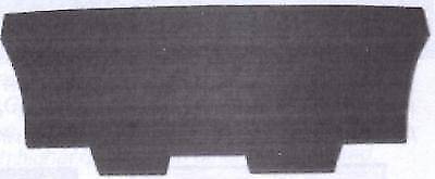

look on REM'S web site and see if they show/offer different ones for 2 and 4 door cars.....I think they are the same. I have both here in my cars but the cars are done so can't take them out.

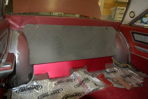

I think the 2dr dividers are different than 4drs but can you snap a picture of your 4dr one so I can compare once I get a 2dr divider?
Thanks!
Here you go James:
Thanks Mike! That 4dr one looks like the one I have. I thought the one I did was for all 63-65 B bodies but a local but put it in his 64 Dodge and it was too narrow I though. I'm gonna have to check with him again.
kryslerkid, thats for the photo. Yep yours looks like the one I make less those small cutouts.

As far as the online pictures, I think I am the ONLY guy that shows real pictures of real parts that I took myself. Bad thing is now every scammer is taking my picture and changing the background. Who knows what they're selling but I guarantee it wont be as nice as the picture they stole from me :) That REM picture above is just wrong. If you look at that guys listings he uses the wrong pictures on most items. Other guys list a trunk divider fitting both "67-69 Barracuda's and 70-74 E bodies". Not only is that wrong, those dividers couldn't be more different. Such terrible info online. I try to differentiate myself by actually doing the research, obtaining a collection of samples, making and then actually test fitting everything I make/sell.

I have one from a '65 Dodge Coronet 500. I can take pictures of it or ship one to you. At first glance the Dodge one looks identical to the Ply one you have posted. Might be slight difference if they are laid side by side but I don't see the difference from the picture.

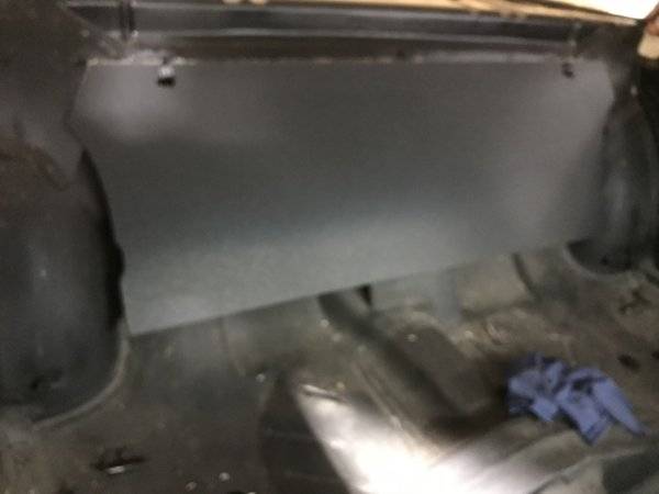

Sorry for the crappy photo but this is my 62-65 B Body (?) trunk divider in a 64 330 2dht. You can see it's about 4" too narrow overall and about 4" or more too short. Maybe shorter if its supposed to ave a cutout over the trans tunnel.

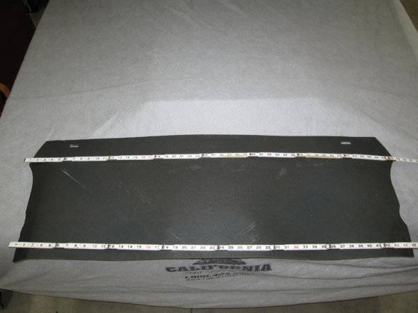

My divider is 48 3/8 tip to tip and 16 5/8 tall. It is about 45 across the bottom. I can send you my old one if you want it for reference. This is out of a '65 Coronet 500.
What I really need you to do is build me a narrower version for my car since my wheel wells have been moved in 1 3/4 each side. Just narrow each side by 1 3/4 and you'll have a "pro street" version which you can add to your catalog. Here are a couple of pictures:
Looks correct to me. I have a few of these dividers and that is what they look like.
