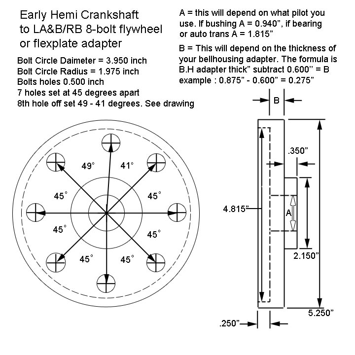

Hi all,
I have a '65 Dodge Coronet, my first car, purchased around 1900 and 75! I've located a drawing on a machinist website for the bell housing dimensions, but I'm also looking for the crank shaft to flex plate/flywheel bolt pattern dimensions and center hole dimensions. I would appreciate any help in locating a drawing, and this would be for the Chrysler RB engines 383, 413, 426, and 440.
Thanks for your time,
Dave

Thanks for the reply. That image brought me to this forum! I forgot to say that I'm looking for the six bolt pattern dimensions.
Dave

Super77se and All,
Thanks, I do have a flex plate, but was trying to avoid measurement errors. I am adapting an electric motor, or motors, to a transmission! You can check out the project on our website:
http://www.bbevs.com/
Thanks,
Dave
