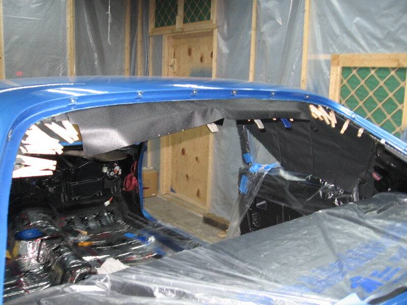

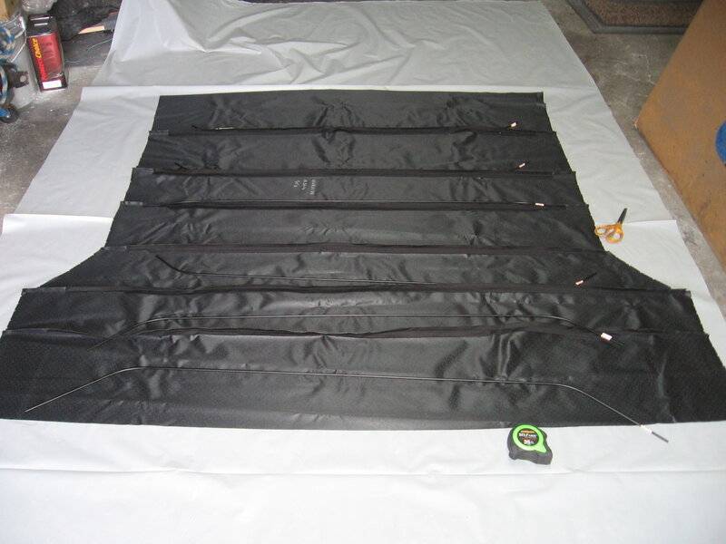

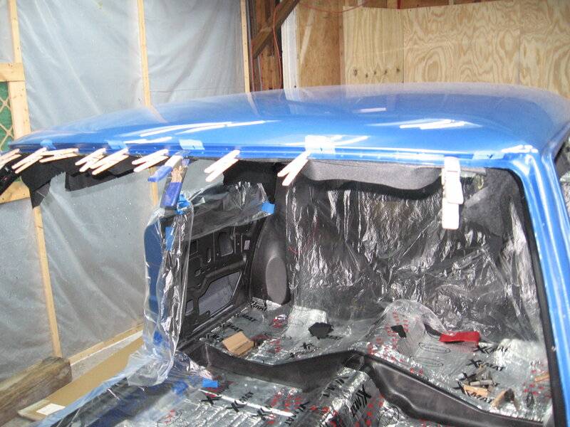

Did my 69 runner by my self. Did not turn out too bad. But suggest to get enough glue. CJ Pony is where I got the glue. Cans where small so should have ordered 3 can's. Just to say. Lets see if I can find the pictures. Used those small tent clamps I call them from Harbor freight. Also bought a bag of new clothes pin's so the wife would not accuse me of steeling her pin's. LOL. Don't forget to cut relief cut's around the back window. At the corners. Start at back and work you way forward. Use a heat gun to take wrinkles out. Suggest you lay it out in the sun first to relax the wrinkles out first. Make 45 degree cut's where the bow's go in. Don't for get to put the retaining wires on the back bow. Good luck.

3 cans of glue? I put my entire headliner into place with zero glue, just the tack plates at front/back, a few spring clamps and the headliner clips like the factory used along the sides and then went back along the edges (when I was happy how it fit) and glued the OUTER edges only with about an 1/8th of a pint can of contact cement.

Think I got more on me than the liner. LOL. Can't seem to open a can of any thing with out getting it all over me.
