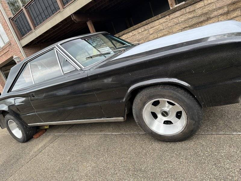

Looking for advice on partial quarter panels for my 67 coronet.
Dean Losego
11:09 PM
Oct 15, 2023
5
25
pittsburgh Pa
I only need around the wheel and outer wheel house due to someone cutting and
flaring existing opening.
66 or 67 coronet 4dr quarters should work if you could find some that aren't rusted out.
Are those Challenger door handles ?
There is a decent patch panel available, but it's kind of hard to find.
I'm not sure it goes up high enough to cover where your car is cut, though.
That Joe Philips does outstanding work.
The compound curves and angles and razor sharp creases on 66/67 quarter panels are VERY difficult to get right no matter the media being worked with.
