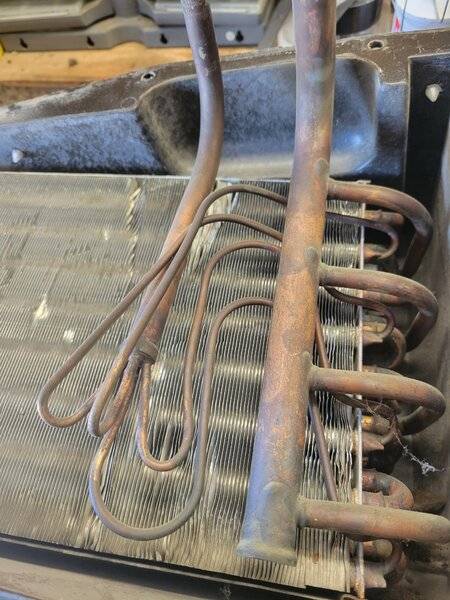

What evaporator did you use? Mine looks like this.
What evaporator did you use? Mine looks like this.View attachment 1248942
The evaporator is inside the car in the box right? If so, I just used the factory one. I never took anything from under my dash out. Only thing was on my '67 there is a "mixer??" I think that's half in n half out the firewall for the heat. Had a small leak n had it rebuilt. I got lucky, this was my Great Grandmother's car and has been in dry Southwest climate in a garage every day of its life.
