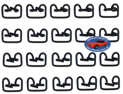

hey everybody I am getting ruby ready to go back together. She's a 66 coronet 500.
On the top of the doors there is a piece of chrome trim that has those teeny little spring clips that look like an x. Anybody know where I can find them?
It is a 3/16 hole right in the very top of the door just outside of the window sweep
There are 7 holes
I'm thinking of trying little Christmas trees
try Restoration Specialties Part# 5179J by the description in the catalog this is very close. phone 814 467 9842 If you buy any please let us know how they fit.
The splash shied clip is a little long and may not hold trim very tight to the body, I just tried one, just my take on them.
