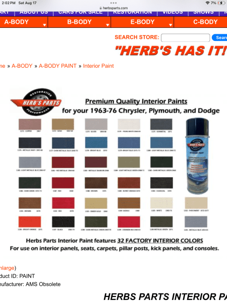

I have a blue interior in my 69 Bee and Herb’s parts has the correct color for the dash pads. I was struggling with the metal dash parts, steering column, etc.

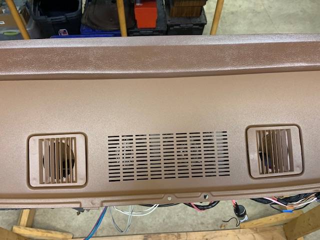

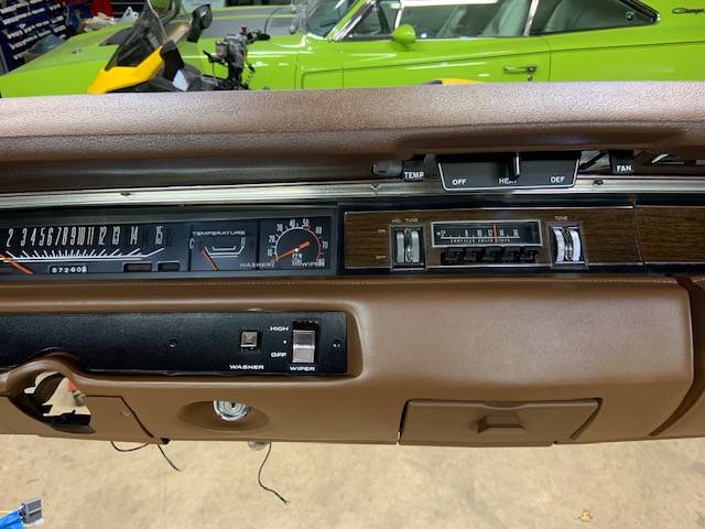

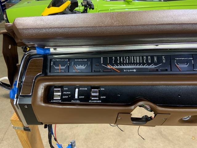

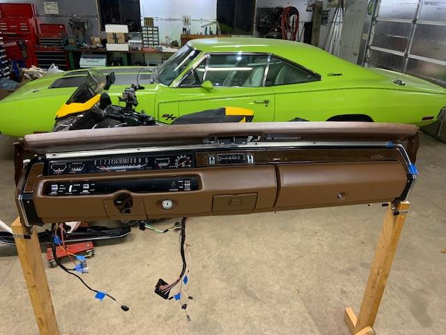

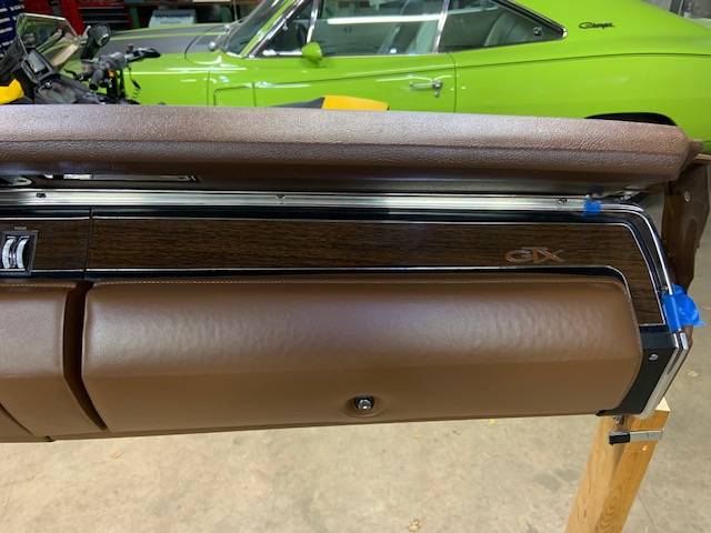

For a customers 69 GTX project I ended up having dye mixed at local paint supplier - Finish Masters. I ordered the the Herbs spray can dye and was not happy with the color. The result of the custom dye mix is shown below. To get the color match I took the original parts to the paint supplier. We found areas no affected by UV light and used those for the color match.
Local automotive paint store should be able to match and mix the color for you either from a code or a good sample.
that's what I'm talking about. Looks great!
