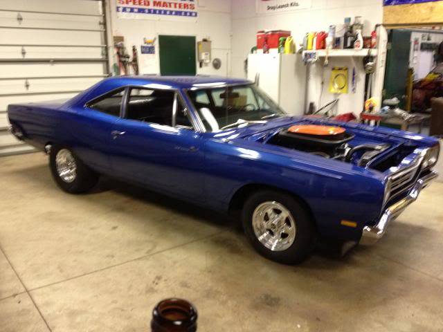

prostars do look good on a roadrunner, i just put a set on mine. 325/50/15 DR on the rear and a 215/70/15 on the front. sorry not the best pictures, as you can see i was drinking when i took them... lol
that looks like exactly what im going for! what size rim and offset did you go with?
fronts are 15x6 with a 3.5 backspace. Rears are 15X8 with a 4.5 back space. i think a 15X10 would have worked on my car because the quarters have been jacked a little but the 8's were free.

MT drag radial on the back and $85 a piece good year radials on the front.
the 325 might be tight if you still have the lips on your quarters. i've heard of people running them though. my car is kind of molested so i have plenty of room.
