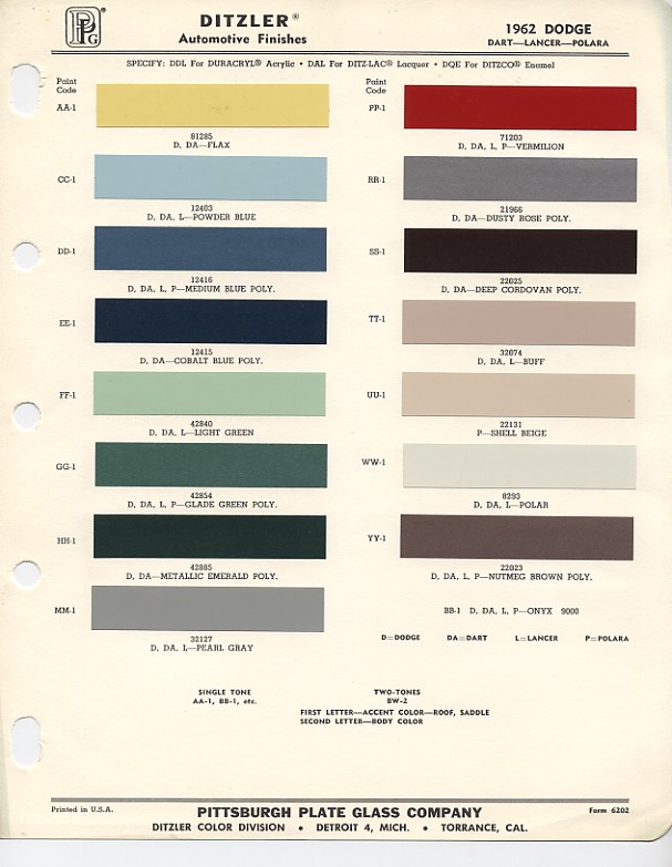

I found pictures of this Dart on the "62-65 car show" thread posted by HEMI-ITIS, and want to paint my '62 Dart this very color which appears to be an off white in color. In one of the pictures there is a chart by the car that says it is "correct flax white color paint". Everything I can find on the original factory paint codes for 1962 show a "Flax" which is definitely a yellow and of course the "polar white" being the only white. I can't find "Flax white" anywhere. Can anyone shed light on this or know more about this color? Thanks for the help!

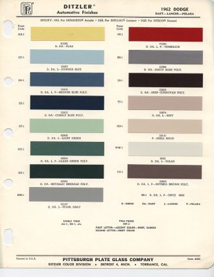

No way to be certain without seeing the fender tag, but I'd bet that "WW" or Polar White is the actual color. Lighting in those tents, camera settings, computer monitor settings can all make colors look different than we expect.
That looks like WW1, especially in the 4th picture. Same as ermine white (WW1)
