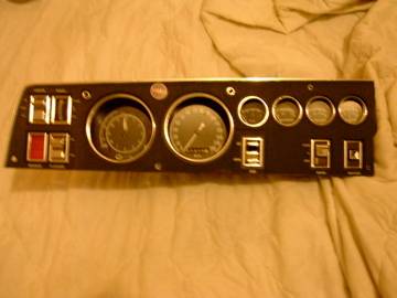

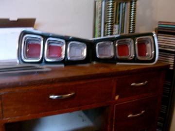

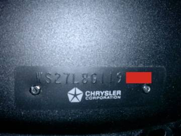

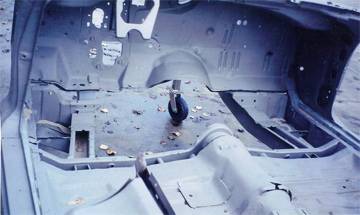

Someday soon I hope to have something more to show but it's been a stalled project for to long.... I've cleared everything that got in the way & the Coronet is back at the front of the line.... So how about a few teaser pics...
View attachment 805419View attachment 805420View attachment 805421View attachment 805422View attachment 805428
