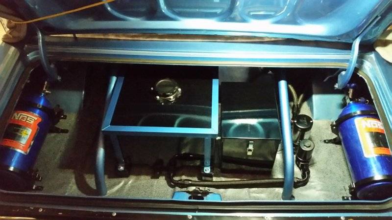

In the future, I'm going to add in an 8 point cage to my 65 Coronet. Currently I'm working in the trunk area retro fitting a Mustang tank in since I've moved the springs inboard and the Stang tank is narrower than the stocker. Since I'm working in the rear rail area, I'm wanting to see pictures of the rear roll cage down bars to see where they may weld onto the stock frame rails. I want to have the general area ready for them when I do get the chance to put the cage in. I would like to get my tank install wrapped up prior to that. Anyone have any photos handy? Going to use S&W or Rhodes for the unit. Thank you!
My down bars tie into the frame rails, also ties in the parachute cross bar and my rear leaf spring rear shackles all tie into the cross bar.
