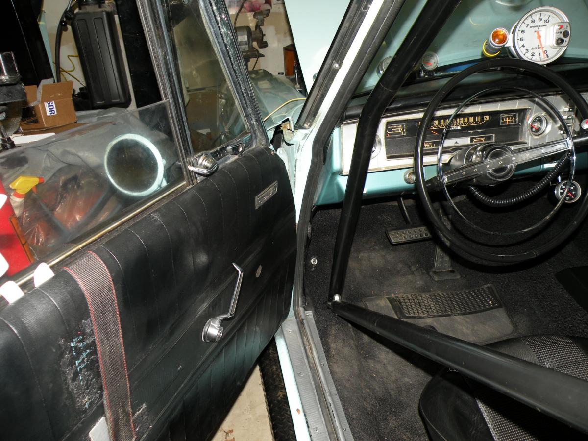

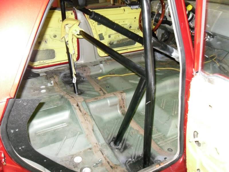

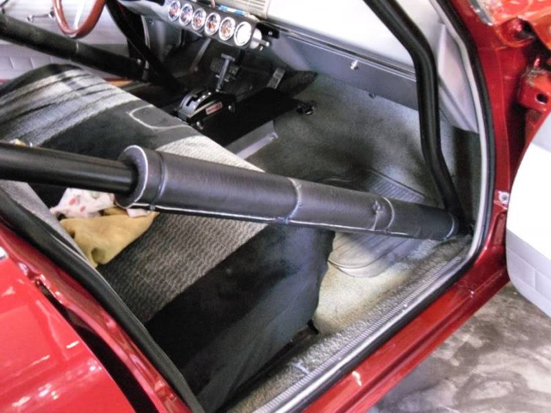

Here are a few of my 62'. Hope they help
Hey Stumper, Looks real good to me.... I need one!!!!!!!!!
Did you build it from scratch or is it a kit??????
also do the front drivers section swing out???
Thanks Bro!
It was in the car when I bought it so not sure of the brand. I'm sure it was a purchased kit though. Both of the front diaginals swing out. Can't really see it well in the photos but the inside rear legs are welded to the frame connectors that are under the car. The other 6 are welded to a reinforced plate welded to the floor and trunk.

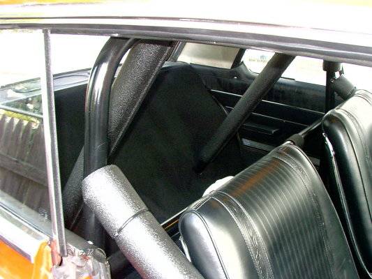

Does it have to be a cage or will a 6 point bar do ? I use a 6 point rollbar because my 63 is a street/strip car that see's the track a few times a year. And since you can go down to 10.0 with a 6 point bar and stock firewall I figured thats all I need. This is a kit I installed myself and I am brain dead tonight as I forgot the name of the company ??? Its a big company in PA and I cant believe I cant remember their name. Ron
I think its "S & W" I believe. Ron

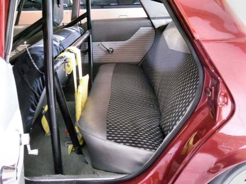

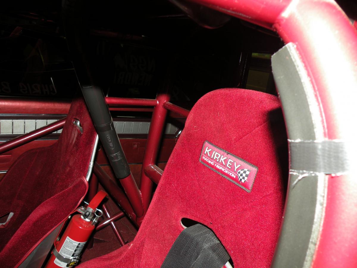

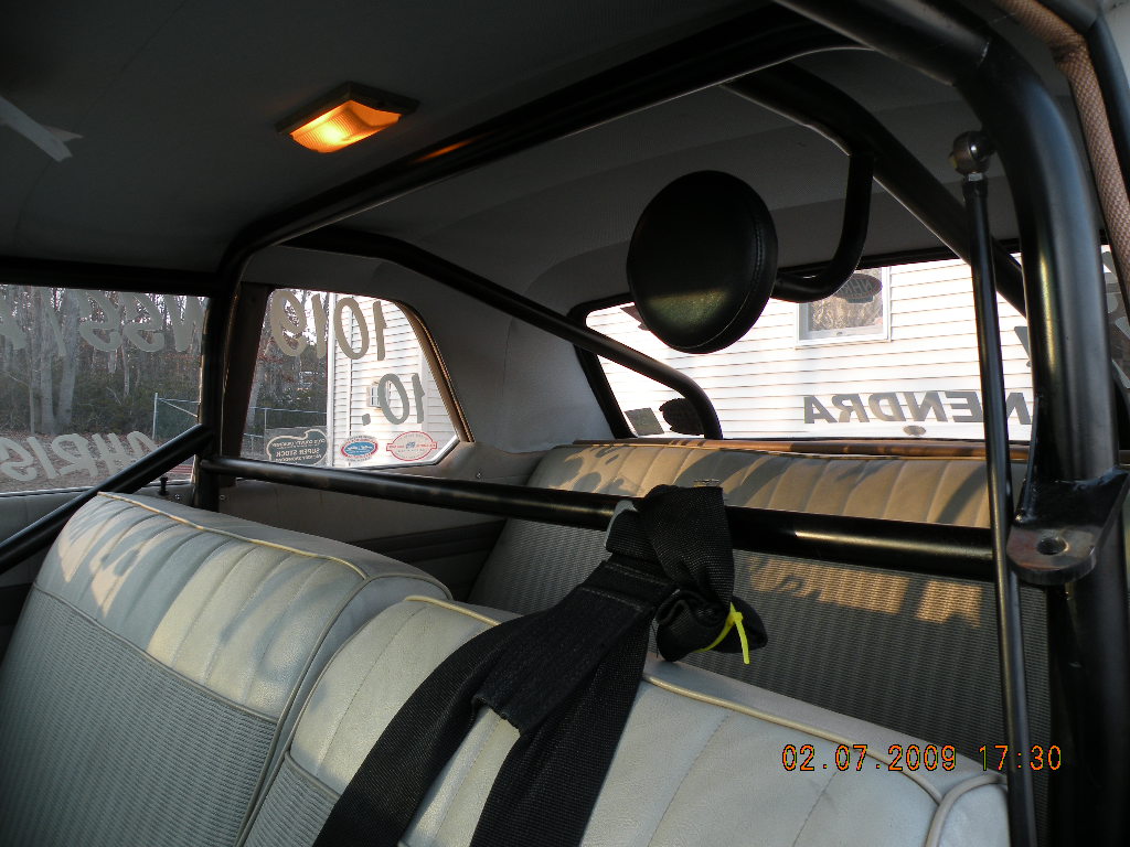

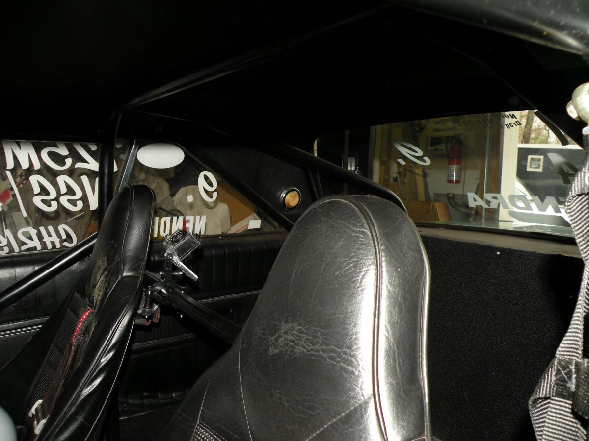

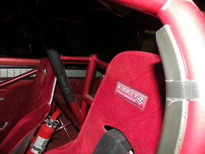

heres all 4 of mine. from 63 plymouth to 2 65 dodges and 1 65 plymouth.

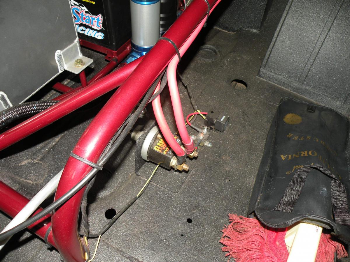

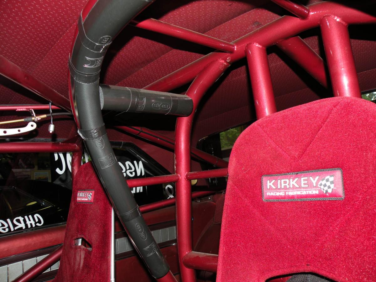

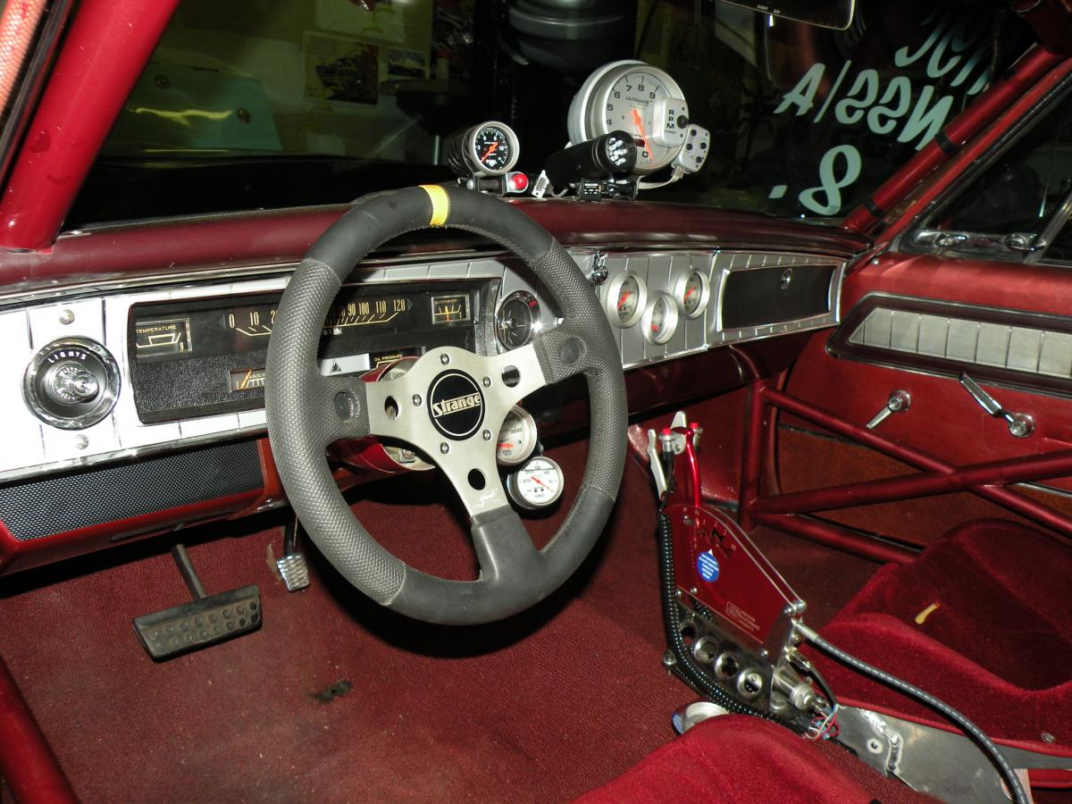

my 65 black dodge 25.5 cage. a little overkill for most.
