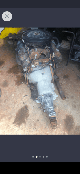

Good day folks! I just want to touch base with other Mopar fans, looking for your advice on things to look for. I found a local ad with a 1978 440-4 barrel with an automatic transmission. I don't know much more about it at this point, except that it is seized. Owner states that he bought it a few years ago to put into his 1974 satellite, but has never gotten around to it. When he picked it up he says that it turned freely, and while he had it in his garage he would intermittently crank it over with a fresh battery. He advises about 6 months ago it stopped turning over. Obviously I have no way of knowing if this is the truth or not. Can you please provide me with some suggestions on things to look for, telltale signs etc that might indicate this engine was abused or neglected. I'm hoping to look at it this week, and if I feel it's reasonable, I will purchase it. I am new to engine rebuilding and I'm going to practice on a 318 I have sitting in my garage before I go full blown on a big block. My satellite which is a 1971 base model, as a 318 with a 907 I believe. I know there's going to be a lot of changes needed, which is fine because I plan on this taking a long time to complete. Please review the pics, and point out anything that you see or think of for me to check before laying down my hard-earned money. Thank you for your assistance.

Probably from an RV, those usually have low miles.
I've pulled apart 2 locked up engines where mice crawled up the exhaust pipe and got inside the cylinder through the tiny valve gap and nested. The urine and crap will lock it up.
The water pump inlet is on the wrong side for your car. Easiest/cheapest thing might be to get a radiator to adapt to the engine (like for a 1973-74 Satellite). That engine shows right side inlet and outlet (water pump inlet/outlet), I would get a radiator that's right side inlet, and left side outlet. The hoses are available for that setup.
And as mentioned, the transmission tail shaft is incorrect for a car. The whole transmission has to be disassembled in order to swap out tail shafts, but your 904 won't work as a donor anyway. However it might be a good candidate for putting a Gear Vendors overdrive on it if you have the $$$.
Also the oil pan, engine mounts, and exhaust manifolds won't work for a car.

Well, I loaded up a cherry picker and headed out in the pickup truck to take a look.
The good, it had all the parts, an extra alternator belts and fan. The thermo quad look to be in good shape.
The bad and it obviously been sitting outside at some point in its life and it was quite Rusty on top. I I tried putting a bit of pressure to see if I could break it free, but it was Rock solid.
The Ugly. I didn't have a borescope to look, but I did pull the dipstick and there was nary a drop of oil on it. There was a little bit of Rusty sludge however which basically killed the deal. I lowballed him because of the risk of taking home a boat anchor, but in the end we could not agree on a price. So I will continue to look for a heart transplant for my satellite. In the meantime I will rebuild my spare 318, in preparation of moving into a bigger displacement. Thank you everyone for your comments and insights I do appreciate it.
