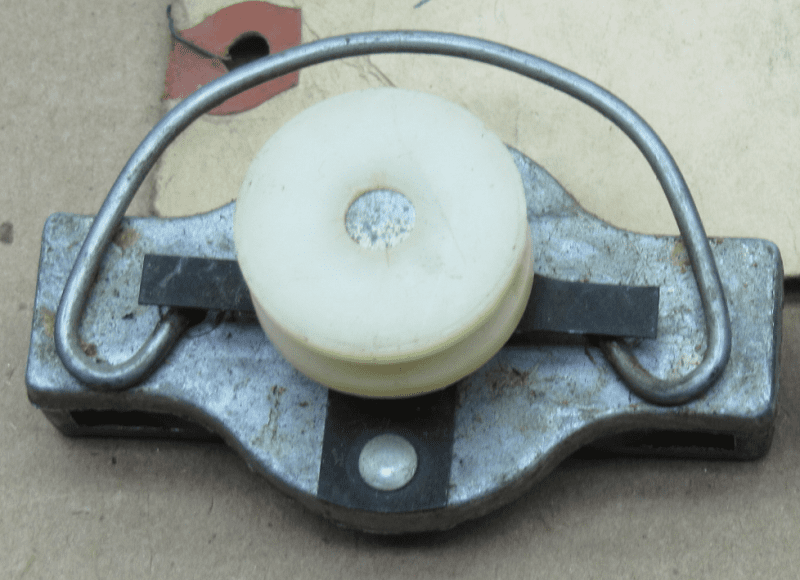

And some of the harder parts to find especially if you need one of the roller brackets.

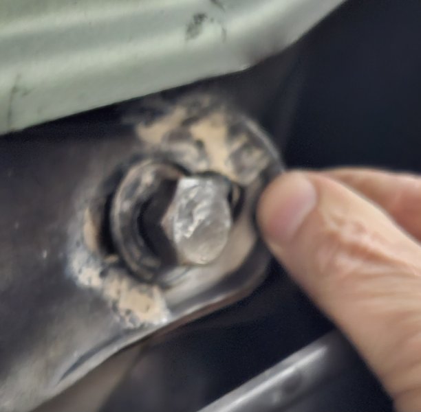

Yea, that bolt is super tight, but looks like it could use a washer or 10.

The other side has a spring on the inside of the washer that holds it right. Pretty interesting.
